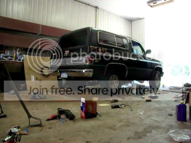

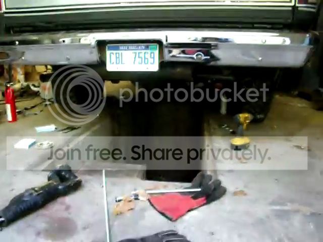

Just after motor install. Note, my mufflers have zero baffling, just straigh through so that's a lot of the loud...
DSCF9819.mp4
See Adam yours runs good, this one however, is what i DONT want,
