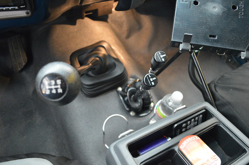

Anymore info on the short throw shifter? My knuckles would love one. Sometimes when I slam second I hit the 205 shifter for the front. Can't turn sifter because of the dash clearance.
As far as I know the short throw shifter only works on trannys with a removable shift tower. Some of the older models the shift tower is part of the top cover. I think the covers can be swapped but not 100% sure on that. Granted thats on the Dodge stuff, GM may be different. Seems like some have made them work though.

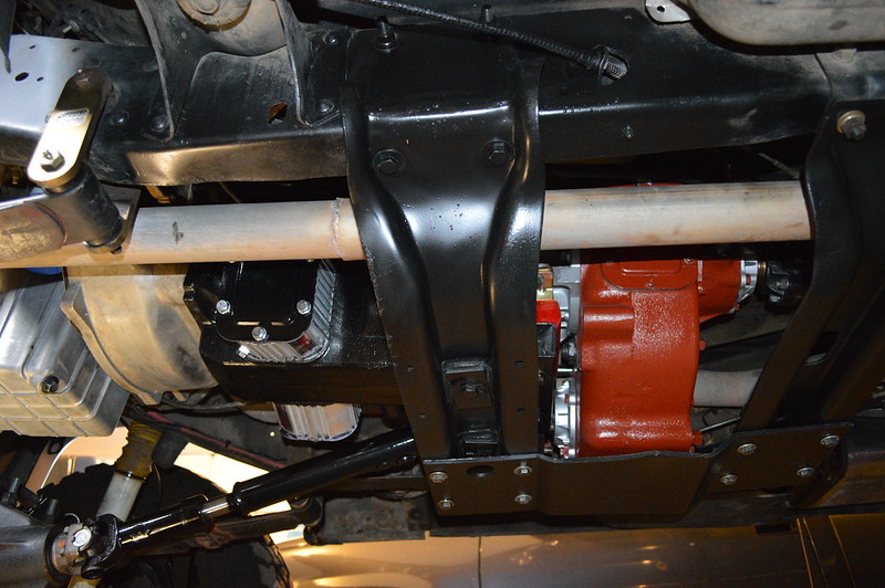

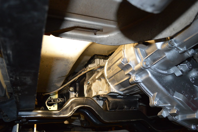

In those pictures, it looks like you're running a mechanical linkage? Does the SM465 bell swap onto a NV4500?
