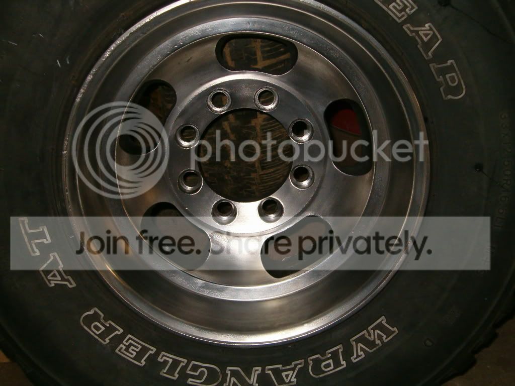

Need some 9/16x18 shank style lug nuts to fit my aluminum dish wheels
The shank diameter has to be .800 and open end would be nice. just a plain jane (if its possible) lugnut, I don't need it to be chrome.
The outer hole is 1.24, so a nut size of 7/8" or 13/16" should work.
And it needs to be at least 2.5" OAL, or open end.
to fit these:
why the hell did you use that wire wheel to clean those rims ? :doah:

and lookin close your lug holes are deep. i bet there the nockoff version of the western wheel stuff. i had a set of the turbine rims that were nockoffs before. just werent the same quality.
why the hell did you use that wire wheel to clean those rims ? :doah:Oh Brett quit bustin my balls...:DIt was handy at the time, and I didn't have the eagle one stuff on the shelf...I used a fine bristle wire wheel...I think they could use some more work, but they might not get it:rolleyes:. I might just bury em in the sand and nail the throttle....sand polishing, yeah that's the ticket:waytogo:

I've checked lots of lugnuts out, but most are a .740 shank diameter, and the hole in my wheels are .810, so I need the .800 shank diameter nuts.

great tips Brett, I picked up a 611-256 today and tried it in both rims. Well it fits em both, but I put the longer studs in, so I would need to cut the end of the stud or the lugnut off, to get them to seat against the rim....
I havent' checked both on the backside to see if/how much they protrude through the rim center.
But they fit good, and I'll be using them.
I was thinking I needed the .800 shank diameter ones $$$ for them.
