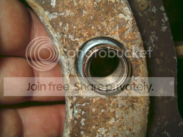

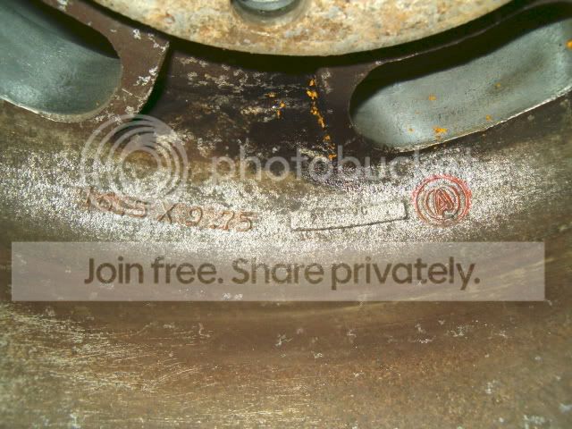

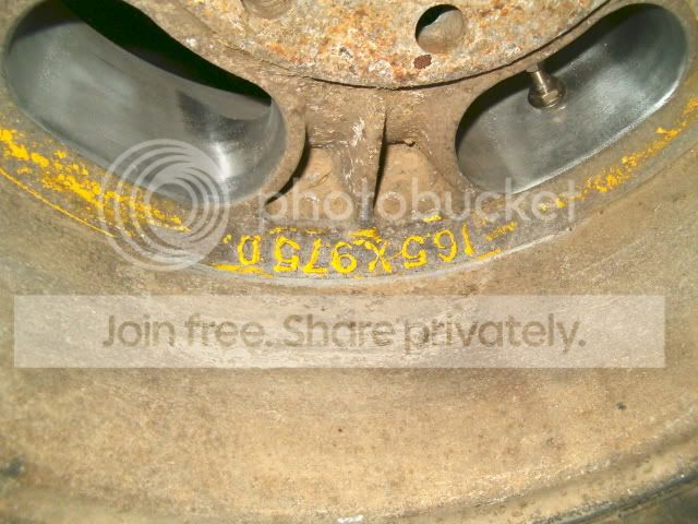

Brett, my one set of two wheels are these (Ansen's?)
They are the ones that are a PITA finding the lugnuts for...

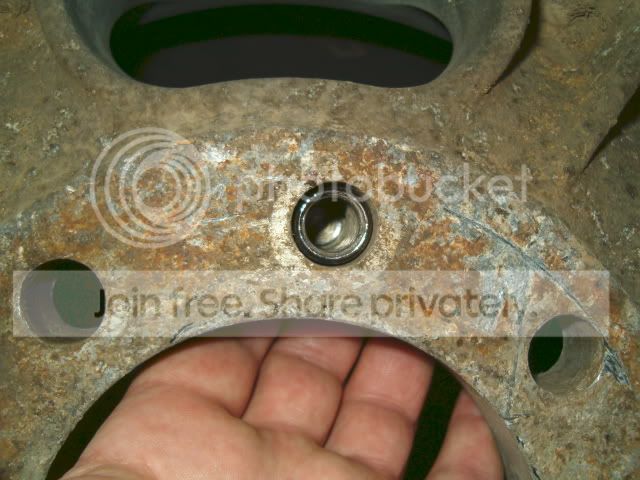

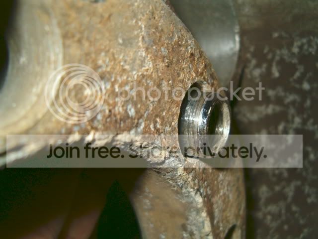

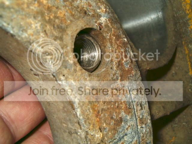

The lugnut hole is .850, and the flange is only .550 thick.... allowing the .730 diameter of the shank to fit quite loosely, and the 1" length of the shank to protrude through too far to seat the rim on the hub..
The other wheels are of unknown origin, if they weren't so old I'd guess they were made in China??...but the lugnuts fit those real nice....just need the longer length which that lugnut place has...
Maybe I could make a spacer to fit around the lugnut shank to take up the slack in between the rim and lugnut on the Ansen wheels????
