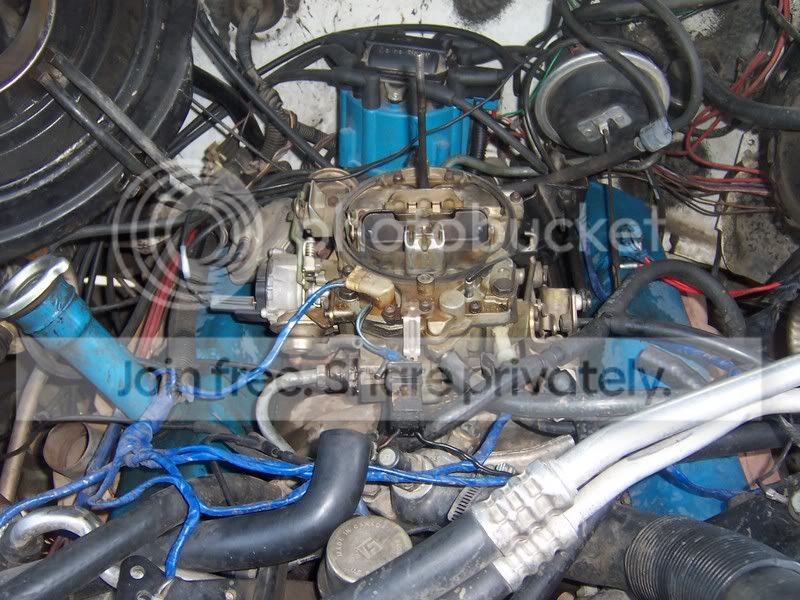

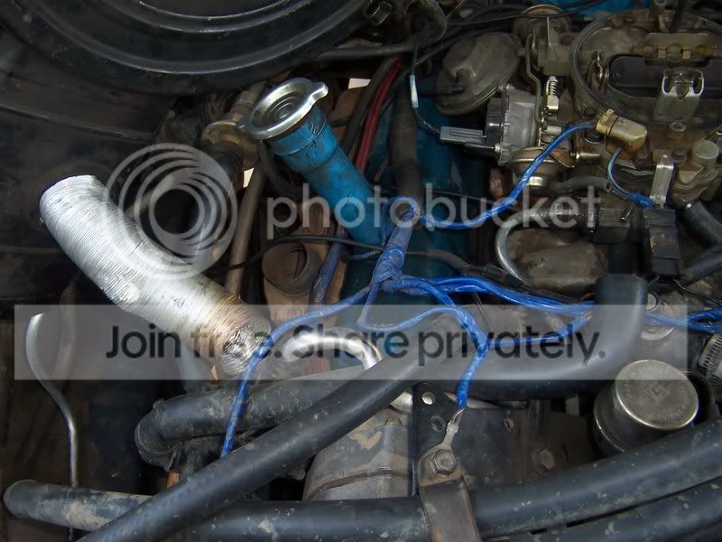

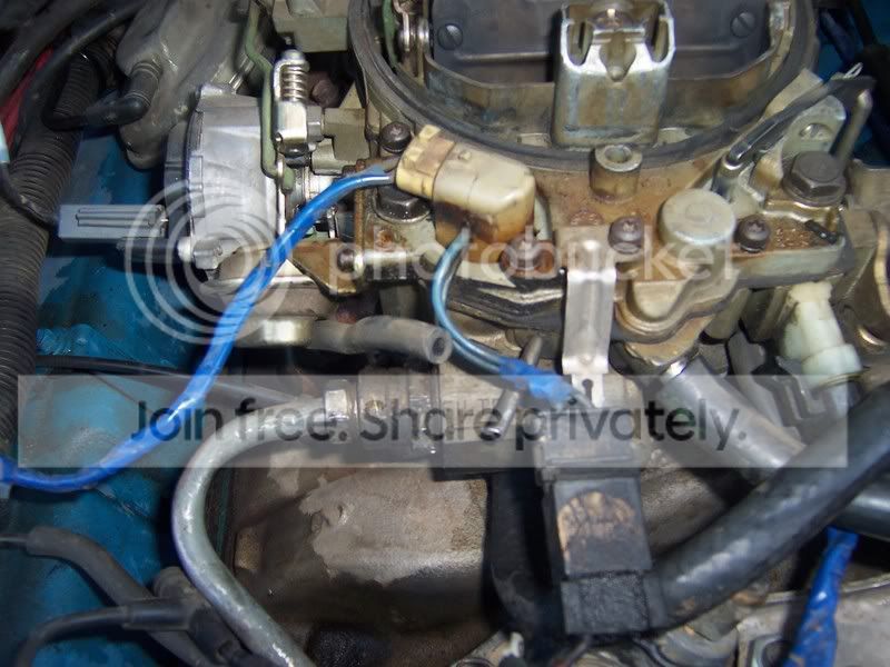

I got some pics everyone...this is the filter I'm talking about...is there another one on the frame rail or is this it?

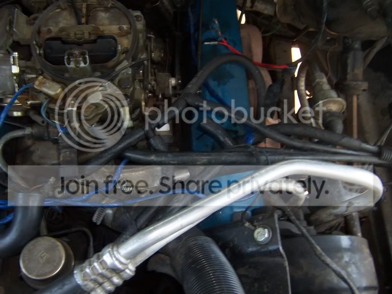

and here are some general pics...where is this EGR valve?
I found the EGR valves you were talking about and checked the vacuume line running to it and its all hooked up.
Both lines running from the manifolds run into one spot and one vacuume line runs to them...
I soaked the threads on that filter up by the carb and I can't get it off...when I try to turn the small collar on the fuel line it turns the big one with it and crimps the fuel line...then if I hold the large collar in place and try to turn the small collar it won't budge...iono what to do guys.
First thing is to change that filter. Use tube wrenches as suggested. The problems you are having in getting it loose is a common one. Use a good penatrating oil and be careful as those connections are very important yet fairly soft so it's easy to screw them up and end up with a real PITA. Work slow and patiently.
Follow the fuel line back, through the pump, to the tank. Look for any other filters on the line and replace those as well.
Until you get the filter(s) changed and cleaned out it's no use to look at other potential problems.
