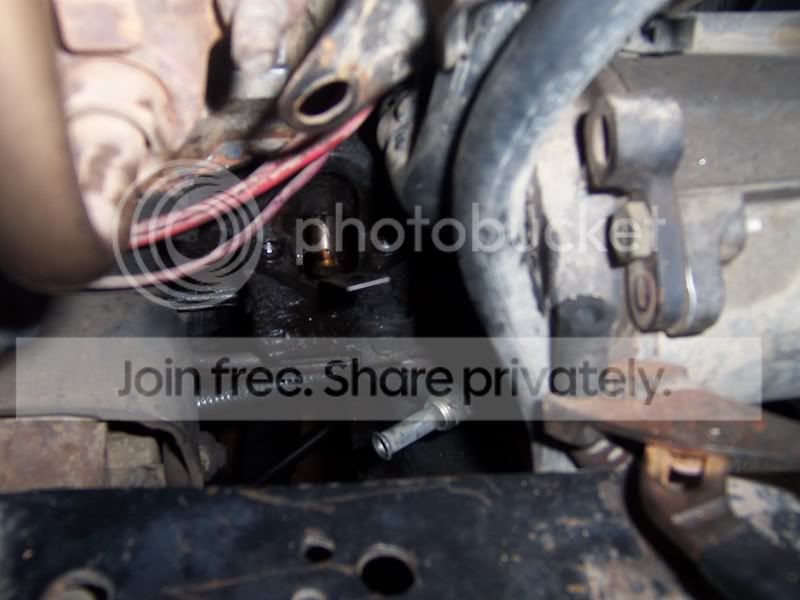

your pump will be able to draw it through the lines, the hard part with replacing those fuel pumps, is getting that push rod up long enough for you to slap the pump on, the rod will fall down in there, it NEEDS to be resting on the lever on the back side of the pump.
You will see the push rod when you remove the old pump, it will most likely fall down and rest on the plate your pump mounts to.

so when I go to put the new one on there is a rod that just sits on top of this thingy...
yes it needs to sit on the indent on that lever thingy.
yea that the hard part about replacing these things. i dont think that "driveshaft" was the right word for me to describe that...
i suck at drawing and the rod is inside the engine. shown in pix and it moves back n forth to pump the thing that its sitting on. to make the fuel go.
Don't let the upside down illustration get you turned around...
And to keep that push rod from sliding back down into your way, you can slather some axle grease on it to help it stick in place. If that doesn't work you there's a short bolt in the front of the block, just around the corner from the pump. You can pull that bolt out and see the side of the push rod, stick a longer bolt in there and it will clamp the pushrod right in place. Makes it pretty easy. Otherwise, you'll soon find out that you weren't equipped with enough fingers to complete the job.
