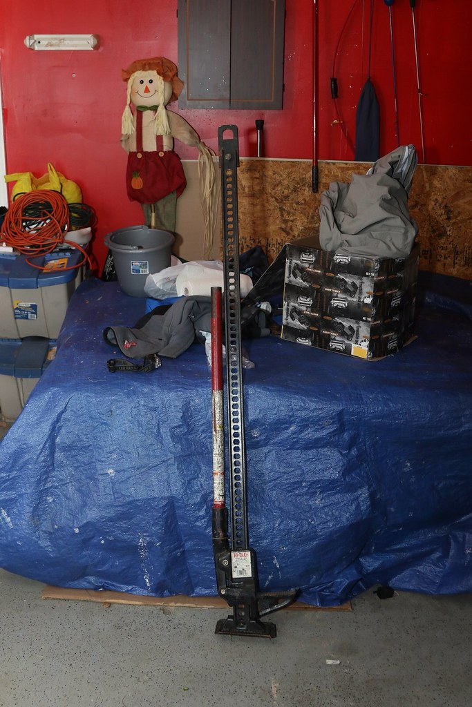

I noticed lil things using my hi-lift jack recently after taking it out of the corner and dusting it off....
more on that another day but wanted to give history before I give this question...
so how do you maintain a hi-lift jack? I will list what I am seeing and curious if you too (who own one) see the same thing...
1. in a video on hi-lift jack usage.. people show raising arm up and lifting.. on downward they lower... but their jack stops... My jack... once no pressure, drops like a rock to the bottom plate banging at the bottom. I don't like that and want to know if there is a fix
2. do you oil/lube jack as it sits outdoors? mine is indoor and it has bound where jacking up is fine but jacking down you have to tap the square unit as the pins seem to bind. figuring lube or oil.. but want to see what others are using..
3. last one... this one is stupid but still.. how to differentiate versions? there must be versions as my other thread..
https://ck5.com/forums/threads/mount-spare-tire-and-hilift-on-fullsize-pickup.330878/#post-3790108
skunked - has a red jack and it has a circular cutout where the handle is. my handle also pulls out super easy.
so with that if you are jacking down.. the jack gets down to no weight.. and drops like a rock. holding the handle and you only pull it out of the jack... ughhhhh
I'm trying to get the safety of my jack to where it needs to be as it is going to be an integral part of my recovery... cant wait to get this stuff going!!!!! and will share out when I do...

Probably needs oiled.
If the flip the lever, it reverses the pin direction of travel and you can ratchet it back down. Or keep using the Ole' method
I have pulled the pins out and scotch brited the crap out of them on lifts that didn't want to work. But spray the bejebus out of it with penetrating oil
aight ive got to get the truck back in the driveway and I'm gonna run the jack through its stretches to see how it reacts... still the handle coming out bothers me.. the part that is supposed to hold the handle in the up right doesn't hold.. it just has been neglected
The handle is just missing the cotter pin..there a hole on the handle that lines up with a space on the jack..or you can drill out the hole and put a nut/bolt in there if you dont need to take the handle off in a timely manner.
The spring that holds the handle up against the jack is just wore out. you can bungie cord it and ignore the rattle or get this http://www.hi-lift.com/accessories/handle-keeper.html
The jack is designed to drop free when it has no weight on it via the switch. saves you from having to ratchet forever
As far as oil I use WD-40

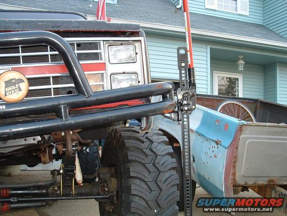

If you think you might actually need the Hi Lift to change a tire then, IMO, it'd be money well spent to get something to limit suspension droop. I'd get a length of chain with hooks to loop over the frame and under the axle to create a loop that will prevent the axle from dropping, this will help to cut down on how high you need to go with the jack. I've seen Hi Lifts with the ratchet 3/4's the way up the rail and that junk gets SCARY! The rail can start to bow causing the jack to lean etc, it can be an accident waiting to happen.
already in my thoughts... just a simple rachet strap to hold it... unless that isn't safe enough but yes.. I will be doing that as well... I'm planning a full on thought on this... LOL

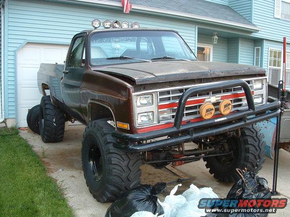

....I've seen Hi Lifts with the ratchet 3/4's the way up the rail and that junk gets SCARY! The rail can start to bow causing the jack to lean etc, it can be an accident waiting to happen.
yeah I took this in 2004 - I think I found out my body mounts were bad so new poly ones on now.. so looks like the bumper is bent but it is not.... ill have to look at that as well when I test this stuff out...
tire barely off the ground so changing a tire would be interesting.... without limiting suspension

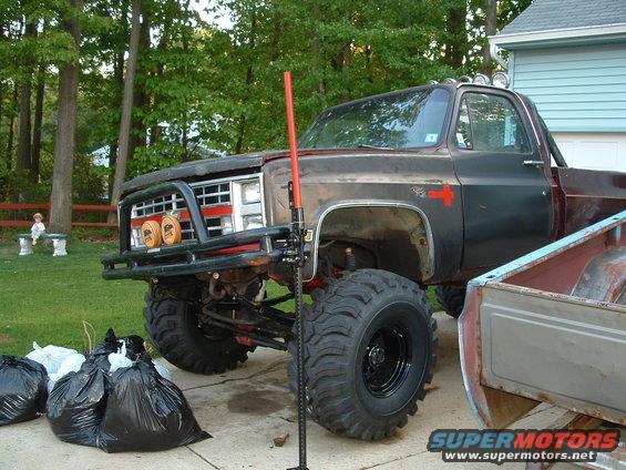

in preview last pic (3rd) shows but when I hit save it shows pic with X on it.. hah
so here http://www.supermotors.net/getfile/193869/fullsize/flex3.jpg
thats why you get the bottle jack...put it under the axle and then it doesnt matter how much suspension flex you have or how tall your tire is. If you build your own base plate you can make it fit the both the high lift and the bottle jack so they dont sink in the soft stuff. You don't need a big jack. You can always stack cribbage under the bottle jack if you need to for the situation. Jacking from the rim is a great idea in thoery..except 99% of the time you need to pull that rim off or move it, turn it, spin it and now you can't. The chain idea works good too..but your lifting the body to lift the suspension and that ads to the overall distance you have to lift the truck to get the tire off the ground.
https://www.harborfreight.com/autom...low-profile-heavy-duty-bottle-jack-69481.html
thats mine and I'm on 42s
You last pics are what I was referring too as a bomb waiting to go off. When the highlift is up that far it does everything it can to kick itself out..now imagine your on wet uneven ground in the wharton state forest trying to rock that wheel off the axle cause the inner bead is completely broke and you need to use your spare. you start pulling on the tire, shaking the truck and boom....highlift kicks out and the truck body is like a giant mouse trap.
If theres a bottle jack under the axle holding the tire off the ground. whole lot friendlier..
