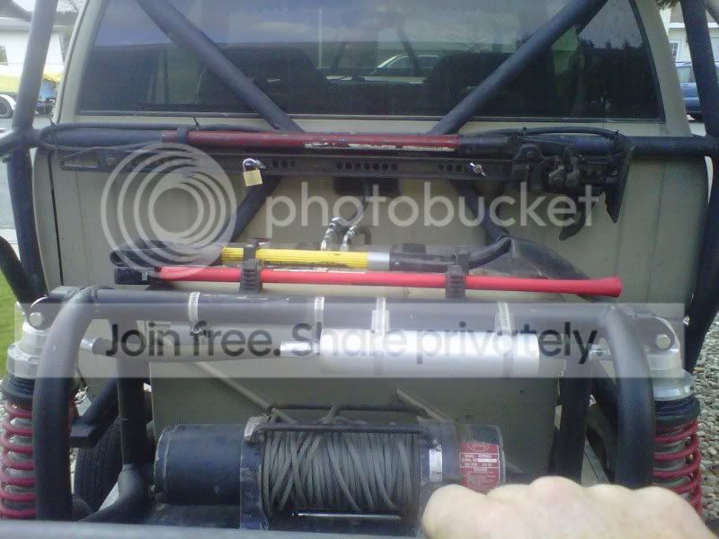

here's my setup. Carry a can of wd40, carb clean, or something to clean the springs/pins when you need to use it.
