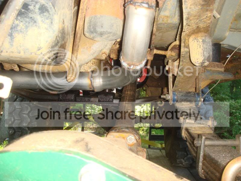

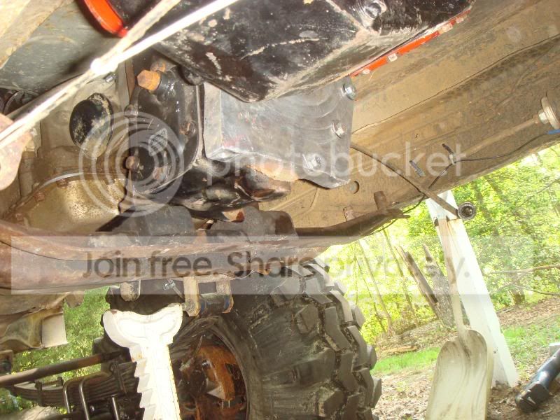

the exhaust is tough..i dont really like the way mine is done but hey it works..
what are you talking about with the doubler??here is how mine is i need to build a crossmember for the 205 though..
mine is also clocked with a 3 inch body lift and i still had to do this

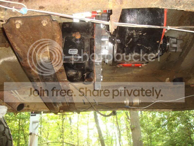

The doubler I have is rotated flat, with the yokes on the 205 level with each other and crossmember is mounted on top. Also, notice the PTO plates are on the bottom, not on the sides like the 2" rotation desgns have. Look at the fourth pic (tan colored flat doubler) in this link: http://www.offroaddesign.com/catalog/CustomDoubler.htm
I have the pic saved but it won't paste.
That setup won't work well with a 203 adapter bolted sideways so I need to find someone to machine it (or machine a one-off) so it bolts up the way it should.

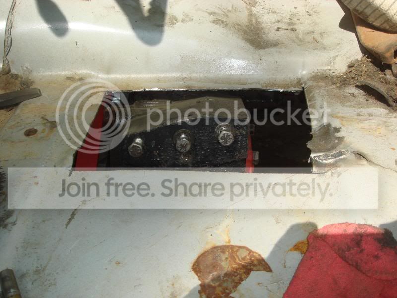

As for the exhaust, I think I can manage to squeeze some duals in close to the framerails, as Wayne did with his clocked flat 241. I expect to cut out a chunk of the floor to make way for the doubler crossmembers but I'll have to talk to Chris, he's a local fabricator and a friend.
