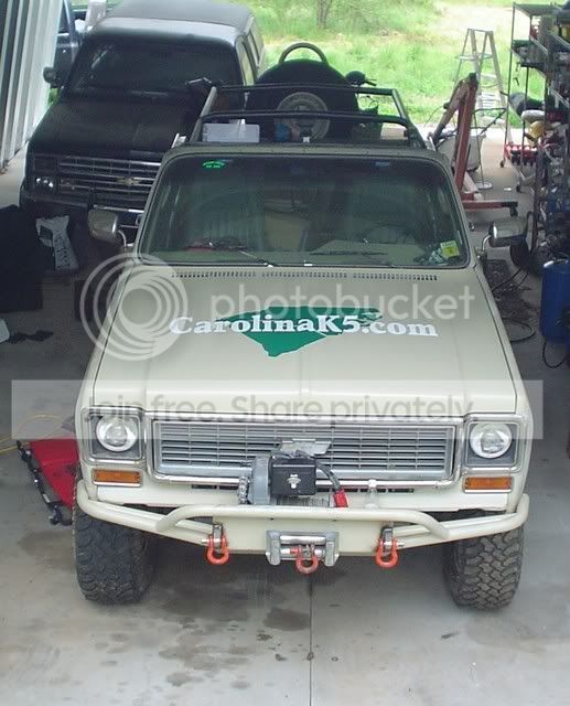

Yep, approach and departure angles were pretty bad. I move the winch plate up ~4" and back ~6" and ditched the sides of the bumper.
Before
After

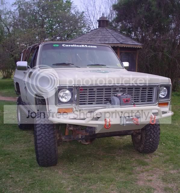

I also wanted a hidden winch when I first got my truck. I like the idea of having a STOUT bumper though. Gives you things to attach tow ropes to. Makes it nice to climb on it to work in the engine bay and in an accident or banging off of trees its going to fair better than the flimsy chrome OEM bumpers.
As far as angles, either step up tire sizes or simple watch your driving and area your in. Sure, ive drug my front and back b4, no biggie. you jus power thru it. If your angle is that bad in the first place you may be in for some real trouble. lol.
Here is my bumper with winch. This is 2" lift with 32"s. Ive since put on some M/T 33s

Badmix, I love the looks of the bumper you have on the truck, but from the pictures I imagined it stuck out alot farther. but now after seeing it from this angle it doesnt seem to stick out to far. BTY way your running about the same hight as my truck, I got a rancho 2.5 inch lift, but in reality its probaly closer to 3, and I am ruuning 33's as well.
EDIT: what winch are ya running in there?

Ive got Harbor Freight 9k
