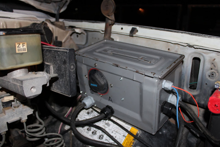

I used one to house my dual battery stuff.
picasa web album
Thread about the dual battery setup.

I like that secondary battery idea too Buddy. Looks like you have it setup so it is close to if not water tight?
I tried to make it water tight & if I did it again, it would likely come out a lot better, but I think that only the lid is really water-tight on it at this point. Will I redo it with another ammo can? Maybe, but for now it works & will allow me to move onto other projects on the blazer.
