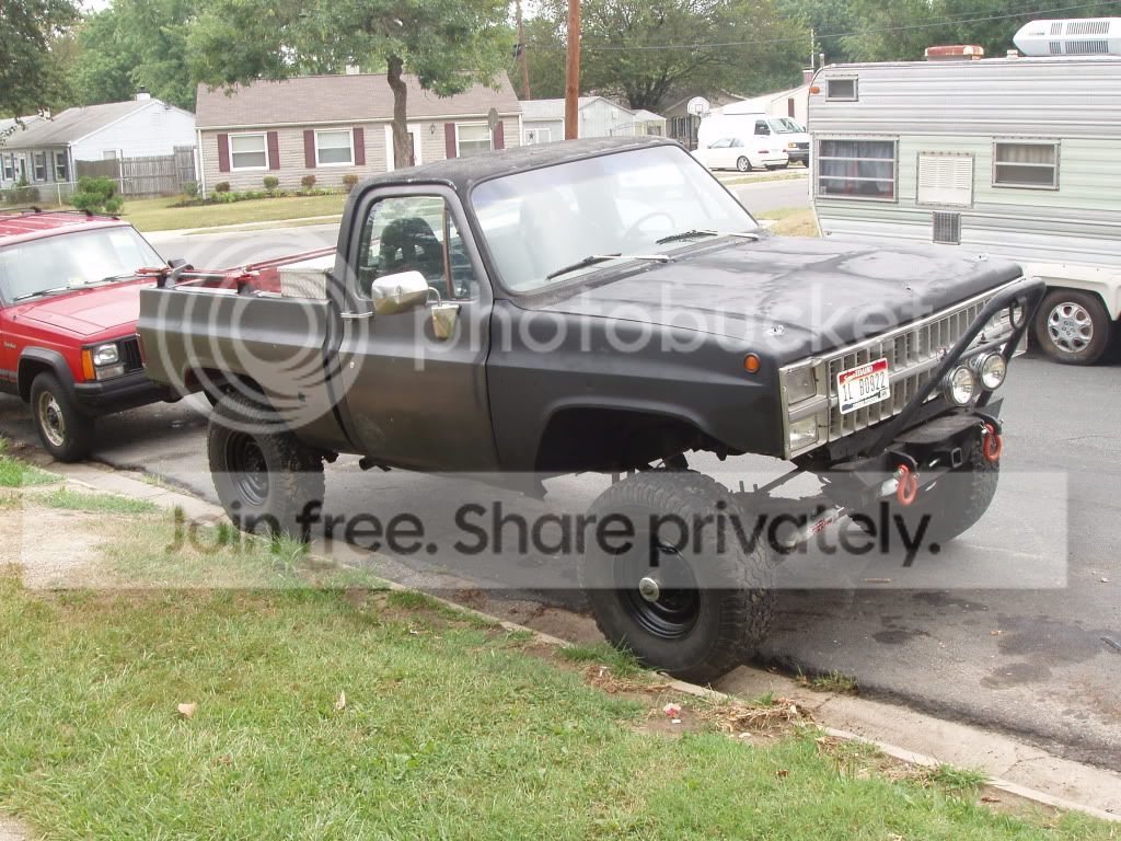

It depends on what type of truck and what YOUR mounting options are..not everyone can mount them like someone else. Mine wasnt cheap. the mounts cost about $175bux,,someone could fab similar cheaper, but im very happy with my mounts. Its quick release as it uses large WING NUTs, and its very secure, ive never had it come loose or anything.
Anyways,,here is mine mounted on the roll bar.

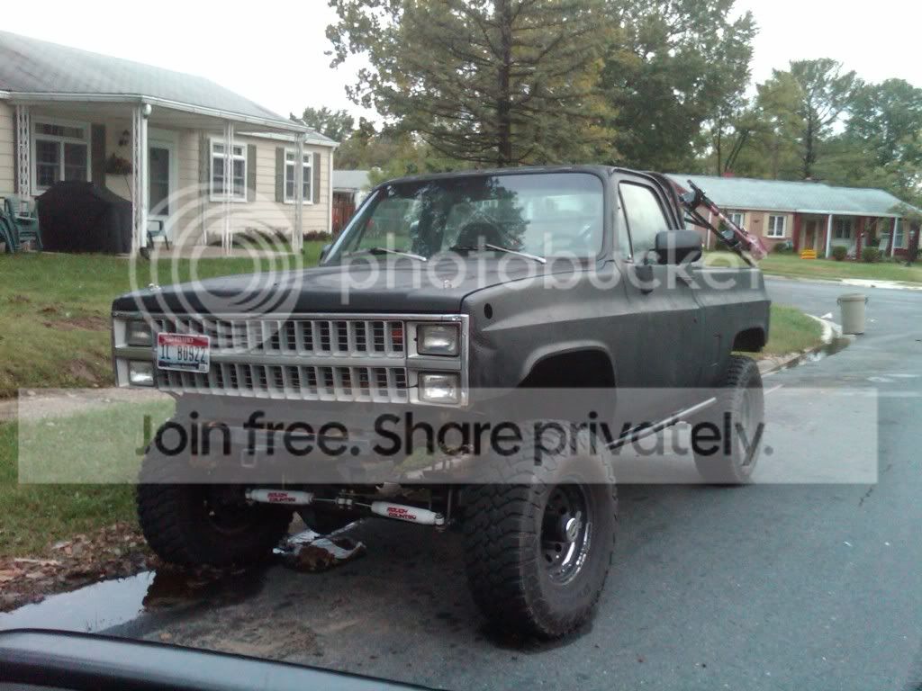

Mine is behind the back seat simply mounted with a couple L brackets and bolts. Find a place where you can deal with it ring there all the time an bolt it down. I didn't bother with wingnuts cause I'm betting I'll never use it.
Here a pic.

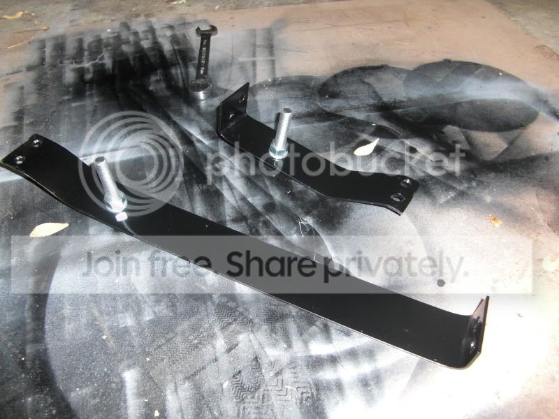

Bingo! One of my buddies did a clean one for his K5, he made one up for me too! I can take some pics if ya need! :waytogo:
what ive seen that im thinking about is, in the driver or passenger side quarter panel over the wheel wells. tucked in and out of the way. youd have to weld in some sort of mounting brackets, and then secure with wingnuts and washers.
Did that for my hi lift. Got a piece of flat bar and bent it up with a vise and hammer. then bolted it in

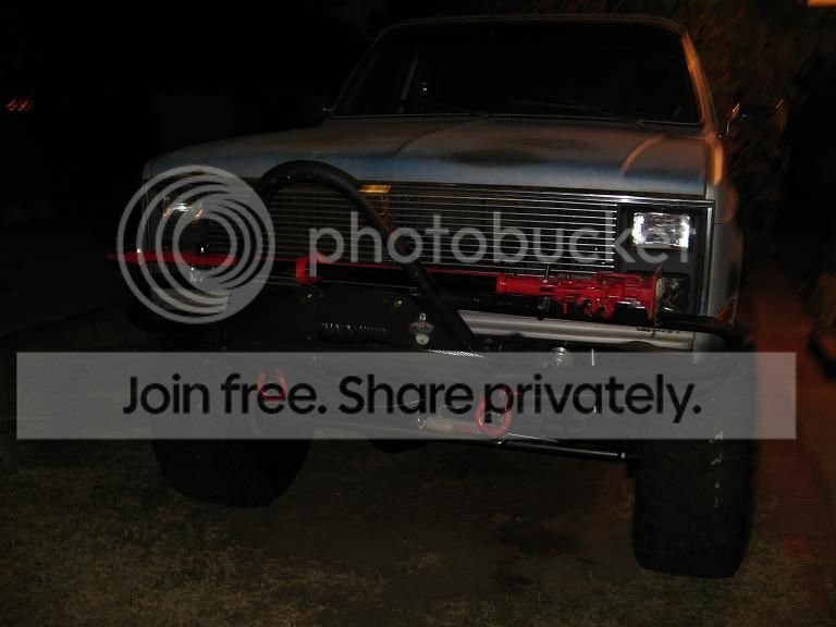

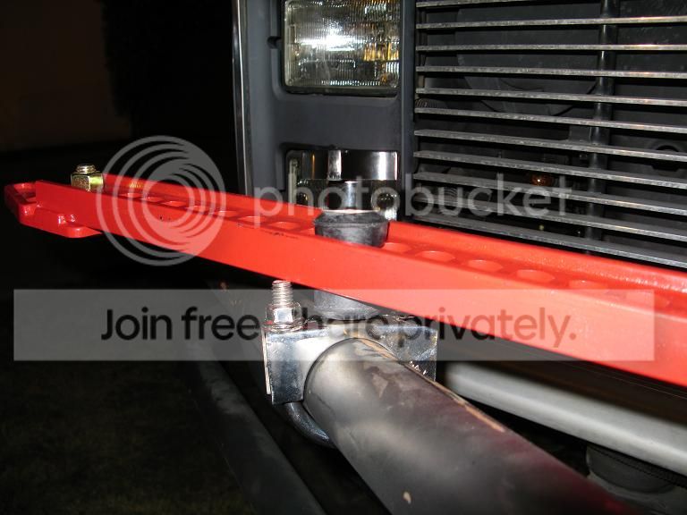

There are several threads about this, but this one is the newest :) Heard about this idea from another member.
Stainless steel exhaust clamps, SS hardware, shock bushings, welded a bolt through the clamp. Nice spin on nut with plastic wings. I still need to cut the extra threads off the U-bolt, they are interfering with the jack sitting on the lower rubber. I wanted to do this over the available mounts I can find on Ebay, I just like it more and super strong.
