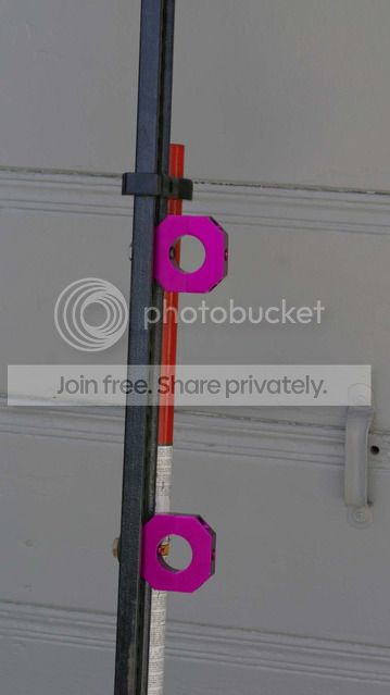

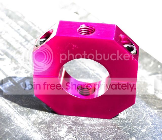

I use a couple of these. Ballast weight mounts for a roundy round car.
$10-$12 each and come in 1 1/4", 1 1/2" 1 3/4" for round tube.
They hold the hi-lift just fine.

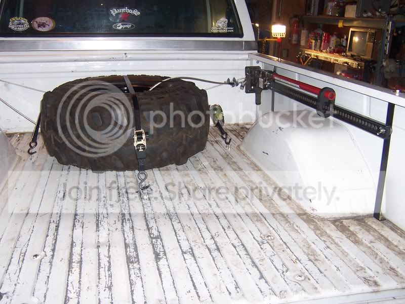

I did the same thing as Norcal_Chris when I still had a bed.
Now I just have a couple bolts welded to the cage that I cut down to the shank and drilled a hole through that fits a BIG cotter pin that's designed to be used on a receiver hitch pin.
Do you still have those brackets? I'd buy 'em if you'd sell them. I know it's probably easy, but I like yours.
