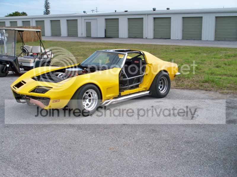

Heres ours
that looks like it has fun written all over it.
