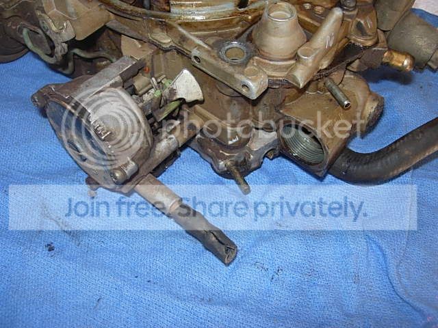

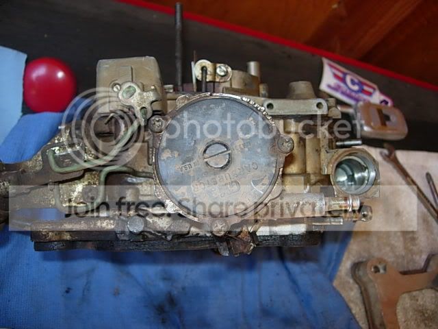

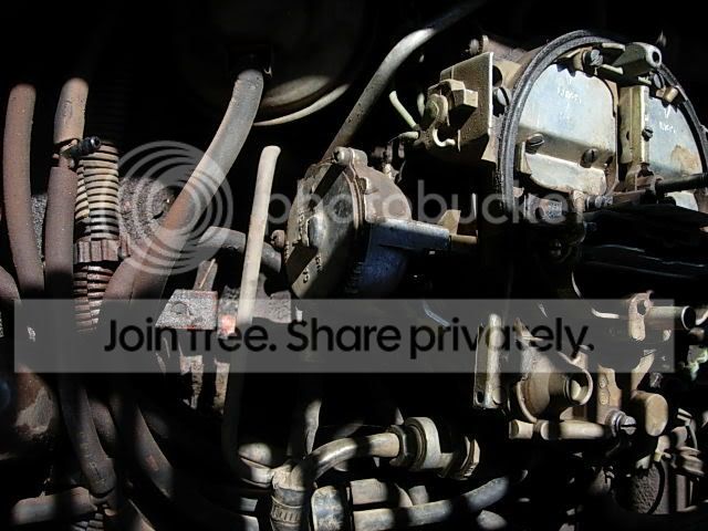

well i got the mounting hardware it fits nicely...the kickdown adapter they sent me was wrong but I went explorin in all the part stores here in town and found a kickdown stud for an edelbrock and it fits the same diameter for my holly..oh and a fuel line....had to buy a new fuel line to give her some gas!! now all that is done...my only snag now is that I don't have electric choke!! or at least I don't have a plug in for it...swear to god my old carb was electric....but there is no plug in...went back to my pictures to find out where the old one plugged in at and there isn't a plug...don't know where it got its juice from.
anyone help me here..if I can't find a source for the carb can I make one straight off any power line? or does it need some sort of relay? don't know anything about installing an electric choke...was runnin off the assumption I would be able to use the same line!
here are some pics of my old carb and the choke set up it had

close up of the choke
<a href="http://photobucket.com" target="_blank"><img src="http://i186.photobucket.com/albums/x231/osoeme/DSCN4799.jpg" border="0" alt="Photo Sharing and Video Hosting at Photobucket"></a>
<a href="http://photobucket.com" target="_blank"><img src="http://i186.photobucket.com/albums/x231/osoeme/DSCN4798.jpg" border="0" alt="Photo Sharing and Video Hosting at Photobucket"></a>
