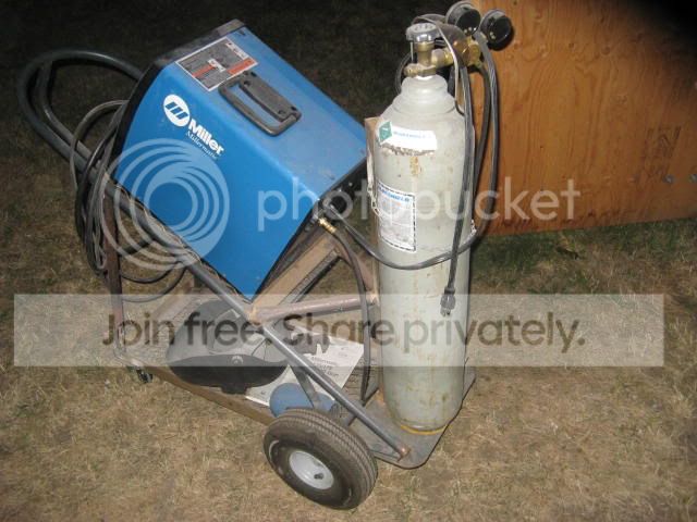

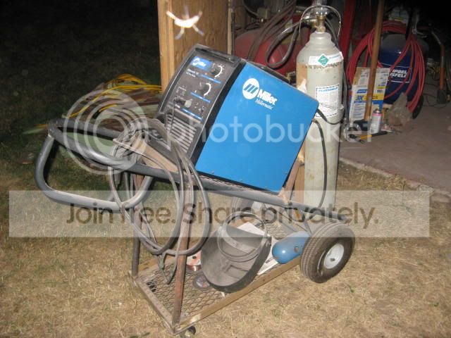

I butchered a moving dolly for my welding cart. I also have a Miller 135 and a small bottle. No paint, no bling and no cash outlay. It's not the sexiest thing I've ever built...but one big upside is the rear wheels under the bottle are good size so it easily goes over some pretty rough terrain.

Couple of pic's...
Like I said, nothing special. I didn't even paint it. :haha:
