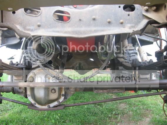

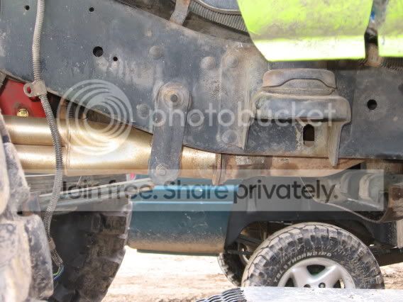

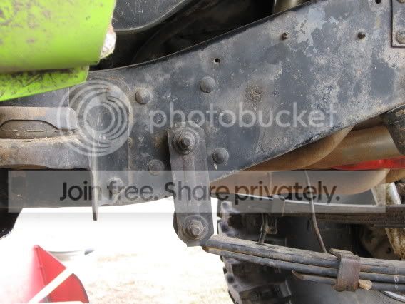

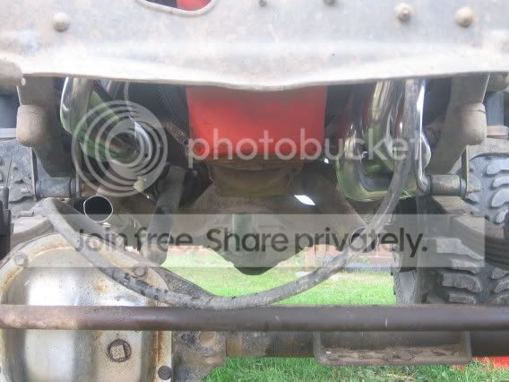

Long tubs hang too low; they are also too close to shackles. I think that for anyone who is going to be off road, short tubs are the way to go. I mean really – is the performance between the two worth the clearance issues. Don’t post up stating that your long tubs provide no clearance problems if you are not going to attach a pic that is taken level from the collector…

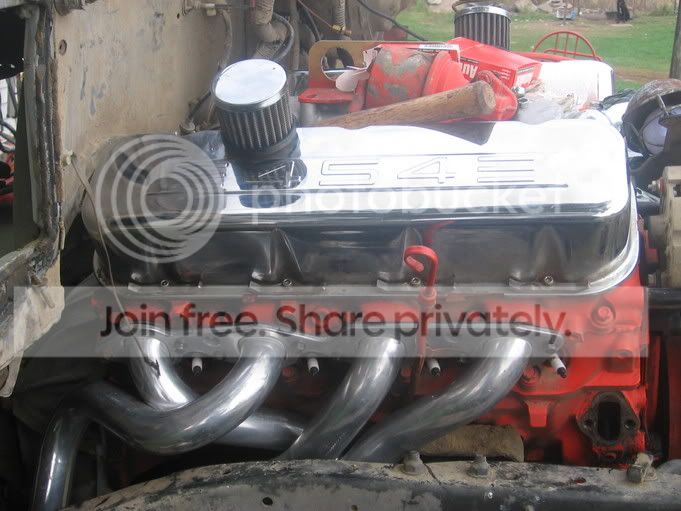

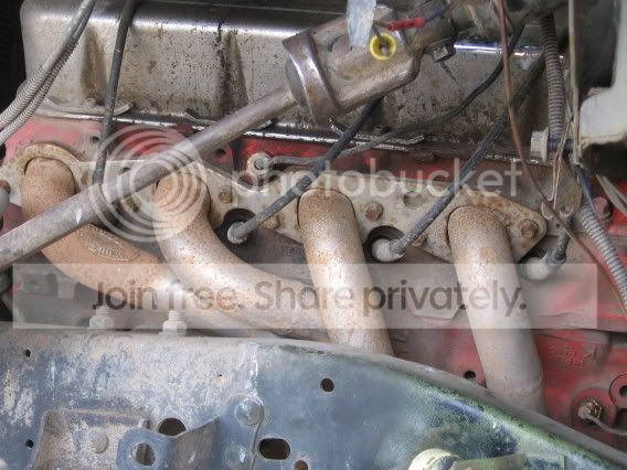

i ran the Headmans with my sbc and they sucked. so i poped for the spendy hookers with the coating when i swapped to a bbc. the fit is great but the coating rusted bad over the winter and i just put them on in october:doah:
i'm not going to say that they don't hang down a little (at least on the driver side), but they don't hang down like the headman's did. besides wouldn't you be hitting on the spring and shakle first?
ok i broke down and took som pic of the collectors for ya, mccomas.
and the rusty pic,this is why i'm mad about the coating
