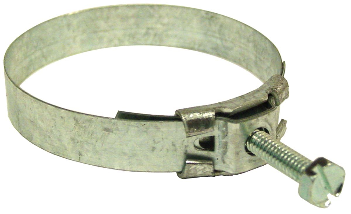

Just throw the factory tower band clamps away. I use stainless Breeze clamps mostly.
What are tower band clamps?
I'm guessing damn ones you squeeze the tabs with pliers to release.
