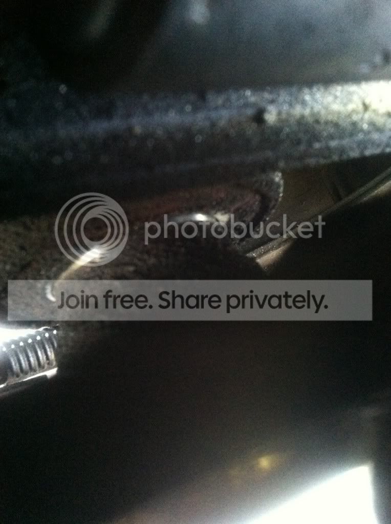

Well, I replaced the froze up adjusting screw that I showed yall last night. I never took the passenger side apart last night to see if it was froze up or not. I went to go replace it and it was fine, free and moving. I did notice that there was more grease on all of the passenger side components (behind the drum) then on the drivers side (the one with the froze up adjusting screw). See Pictures below. I adjusted both sets of shoes and put the wheels back on. I didn't get to notice if the passenger side drum was loose on the shoes or not because I feel like it was kinda dragging or sticky due to the grease. I took the blazer for a test drive and could immediately tell that the brakes felt a lot better. I also noticed the front brakes were making some noise when I would brake. The noise it made, made my wife and I say "it sounds like the rotors are warped". So, we drove to oriellys (1/2 mile away) to get new rotors and pads. Once I got home I felt the hubs and they were not as hot as my initial complaint but still hotter then the rear and I couldn't believe how hot they got just driving that 1 mile total with test drive and trip to oriellys.

You have to pull the hubs and bearings to change the rotors anyways. Look at the bearings and races to make sure they're not scored at all and either replace them if they are or re pack them and call it good. You'll also get to tell if your calipers will collapse or not and clean up the slides.
As far as the rears, it looks like you may have a leaking axle seal on the passenger side. You should probably fix that sooner than later because the gear lube can ruin your shoes and obviously lubricant isn't something that's good for brakes.
the grease on the brake drum components is a bad thing. that grease is making that drum basically inoperable. grease reduces friction and brakes operate with friction. i'd find the source of the grease and fix it first. it's probably the axle seal seeping.
