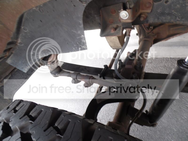

4X4? Adjust the (i think it's called) drag link, the short tie rod thingie coming off the steering box. Turn the center section to make it longer or shorter.
