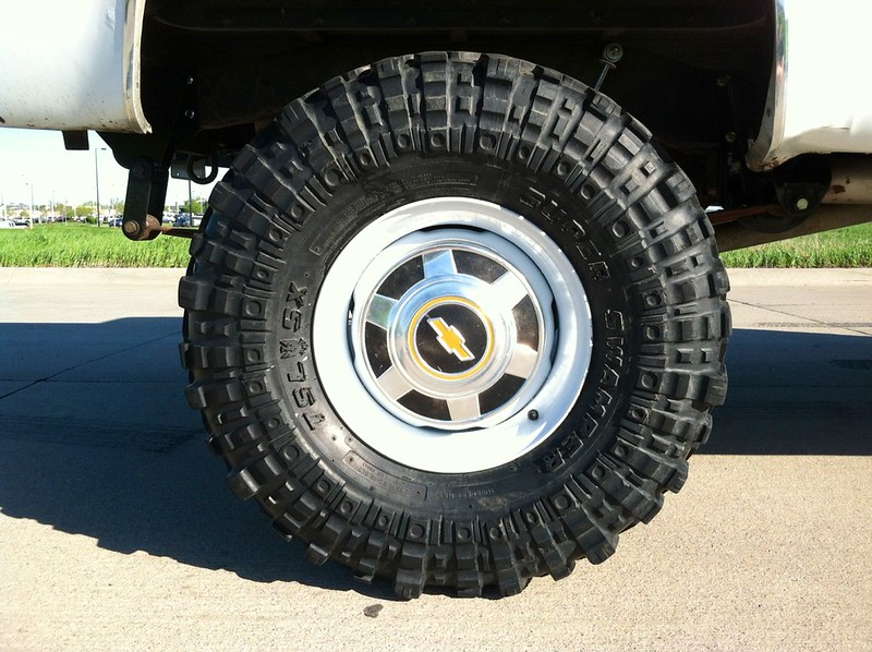

Those 9.5" would be killer in white with factory hubcaps.
Im not sure if there are 16" steelies that allow these hub cabs, im sure Martin could tell you for sure. I will tell you that the 16.5's do for a fact.

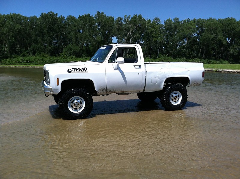

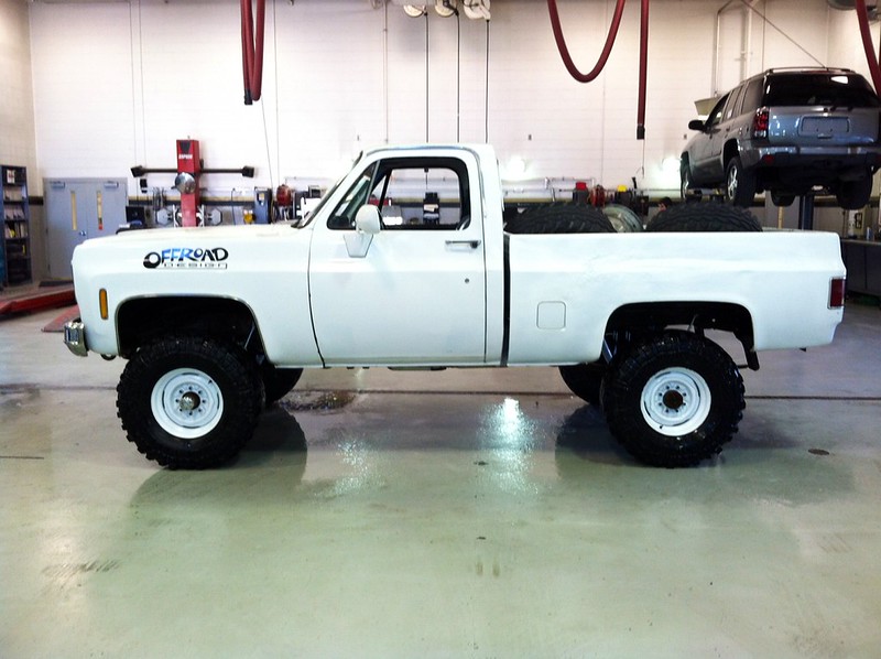

Here are some of my pics to help you find a set.
Hey irish, Are those just rally's or are they wagon wheels? Id like to put the hub caps like those on my rallys.
