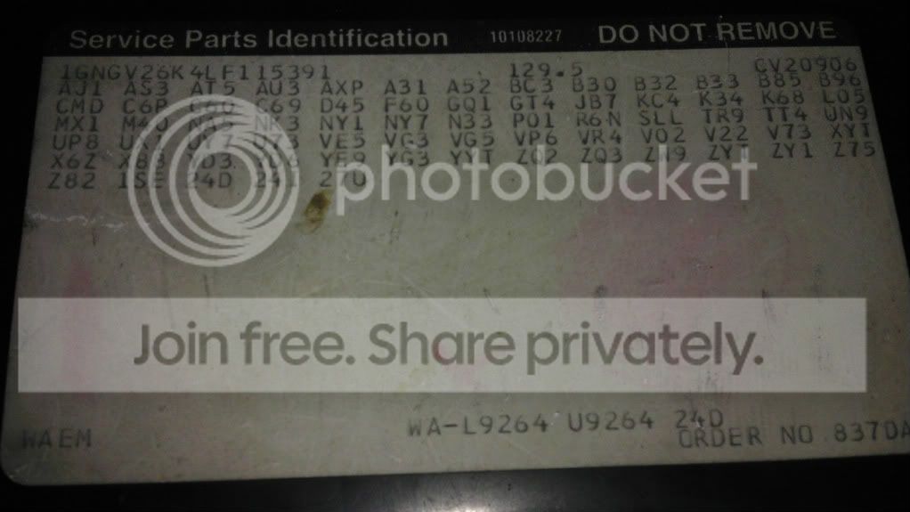

How can i find original color paint for my Suburban?
Then i guess it is french blue poly.
The earlier build sheets did not always get all of the paint code. Mid 90's and later seemed to be OK.
Yes! You called it....it's the Lt French Blue Poly WA-9264 (4146)
You should be able to get that online or the local DuPont Auto Paint dealer should be able to cross reference it. They can even put it in a rattle can for you.

As the possibliity of paint looms in my future, I got to wondering more about the paint codes. Should i be concerned that in the sales brochure its called Smoke Blue Metallic, but in the PPG chip book its Light French Blue Poly?
My paint color is known by many names..."Yellow Gold" and "Sunset Gold" for example. The same paint colors would be given different names...and codes...
If I remember correctly with PPG / Ditzler I found that Chevy, GMC and Dodge used the same color and they all had their own name for it in the brochures but the Ditzler code was the same.
