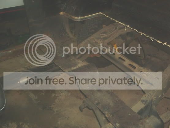

Well JDNobodi, after looking at other people's example of how to install an Art Carr shifter, I decided to make my own shifter mount.
I made a little platform for mine so i can still use the plastic housing. The cool thing is that it has allowed me to adjust where the shifter is located. I've moved it forward and closer to the seat since this pic:
I found a cheap console at Walmart I will use with the shifter. I don't have it mounted yet.
