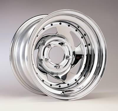

I'm considering putting my 33" Kumho's on some 15x10 chrome blade wheels for the summer. I like the looks of these rims from the pictures that I've seen.
Just wondering what specs I should order. I suppose if I was smart, I'd wait, should I decide to upgrade to 8-lug axles..:doah: but that may not be the case as I'm trying to stay stock-ish... trying... :screwy:

Here's the pick I found in the garage that led me on this search:
