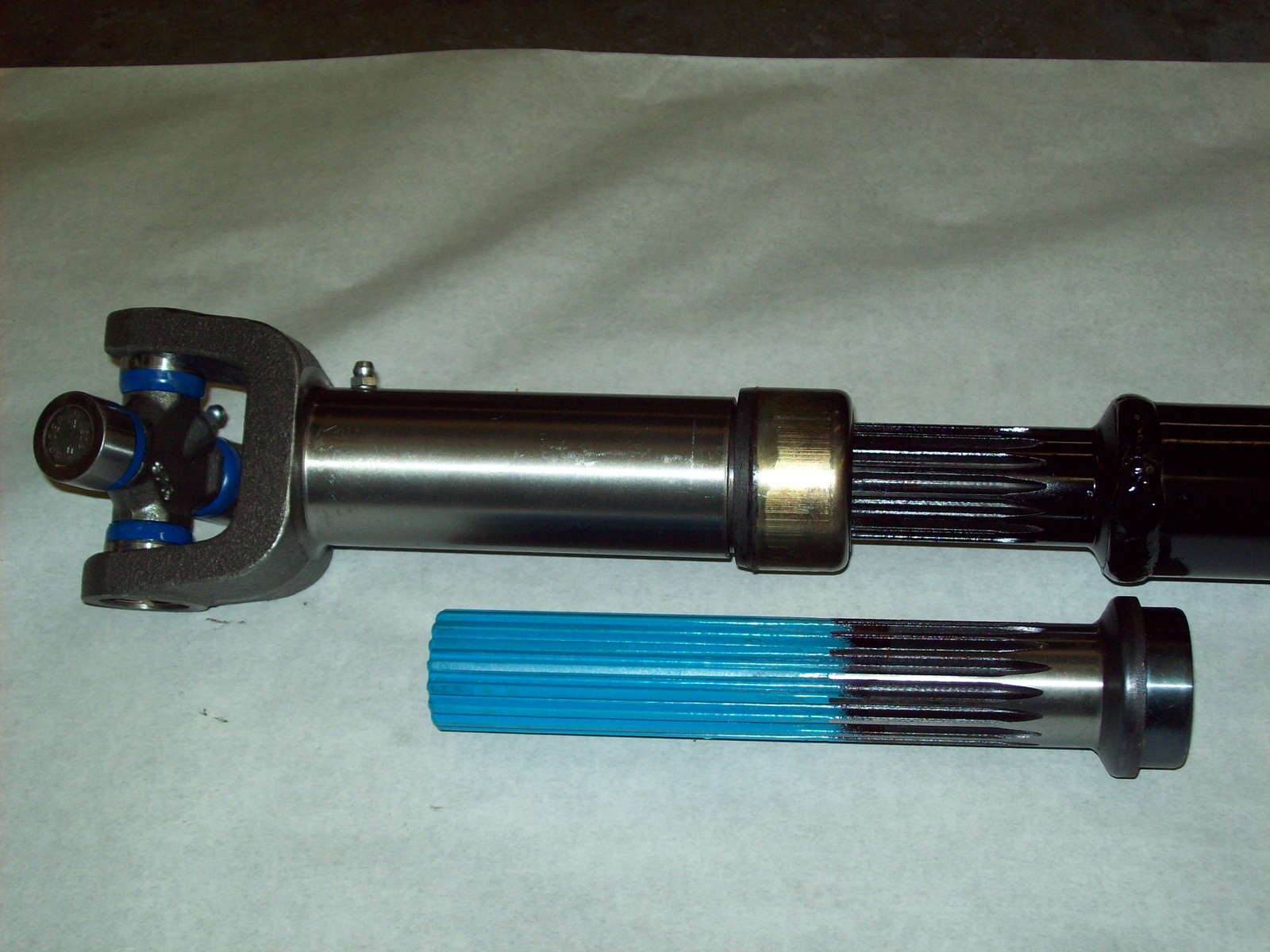

Yeah I'd bet the blue coating has a mark in it right where the broken piece is which would indicate that's where the piece was when it broke.
I'm gonna completely disagree with your driveshaft guy. There is no reason whatsoever to think the t case would have broken.
Hence the reason I wanted to see the male end of the slip. If those splines still left in are twisted, you don't have enough spline engagement or you have enough power and gear reduction to twist them which means you need a finer spline shaft.

That is an odd break. It doesn't appear to be any twisting at all.
I'm sure this is the reason @truck-oholic said it's for lack of spline engagement.
I'm not there it's hard to tell from one picture but the situation you were in is almost the absolute worst case for a front driveshaft.
So it disnt slide. It is not sloppy at all. What happened we believe is the splines were adequately engaged but us it sheared it pulled apart. The twisting would naturally pull the yoke down the splines until it either separated or tore the yoke.
If it was fully extended it would have pulled the yoke completely off.
Here was some good shock loading going on. Towing the trailer limited the forward motion dramatically causing the tires to dig and bite repeatedly
Is the female end splined all the way through the tube? If it is my point was not accurate about it being stuffed.

Too bad you don't still have the shaft or more pics, that blue coating could tell you a lot about what happened.

Are you guys assuming it broke with the amount of engagement shown in the pic? It's possible it slid down or something after it broke, right? Unless the yoke piece was tight on the splines, which would be a big clue.
I wouldn't assume that's where it was at the moment of breakage. Remember that shaft end thats connected to the T-case would have bounced around a few times

So does anybody have a source for a nice slip spline in the 8" range that doesn't rely on blue coating? Or is the general opinion that it's better to replace it every several years for the lack of sticking in the splines? I think the key to the all metal ones is a good dust seal above and limited exposure at the end. Most of these "long travel" splines are open at the end and the dust seal has to travel through the splined area, so a sealed on would be really long.
