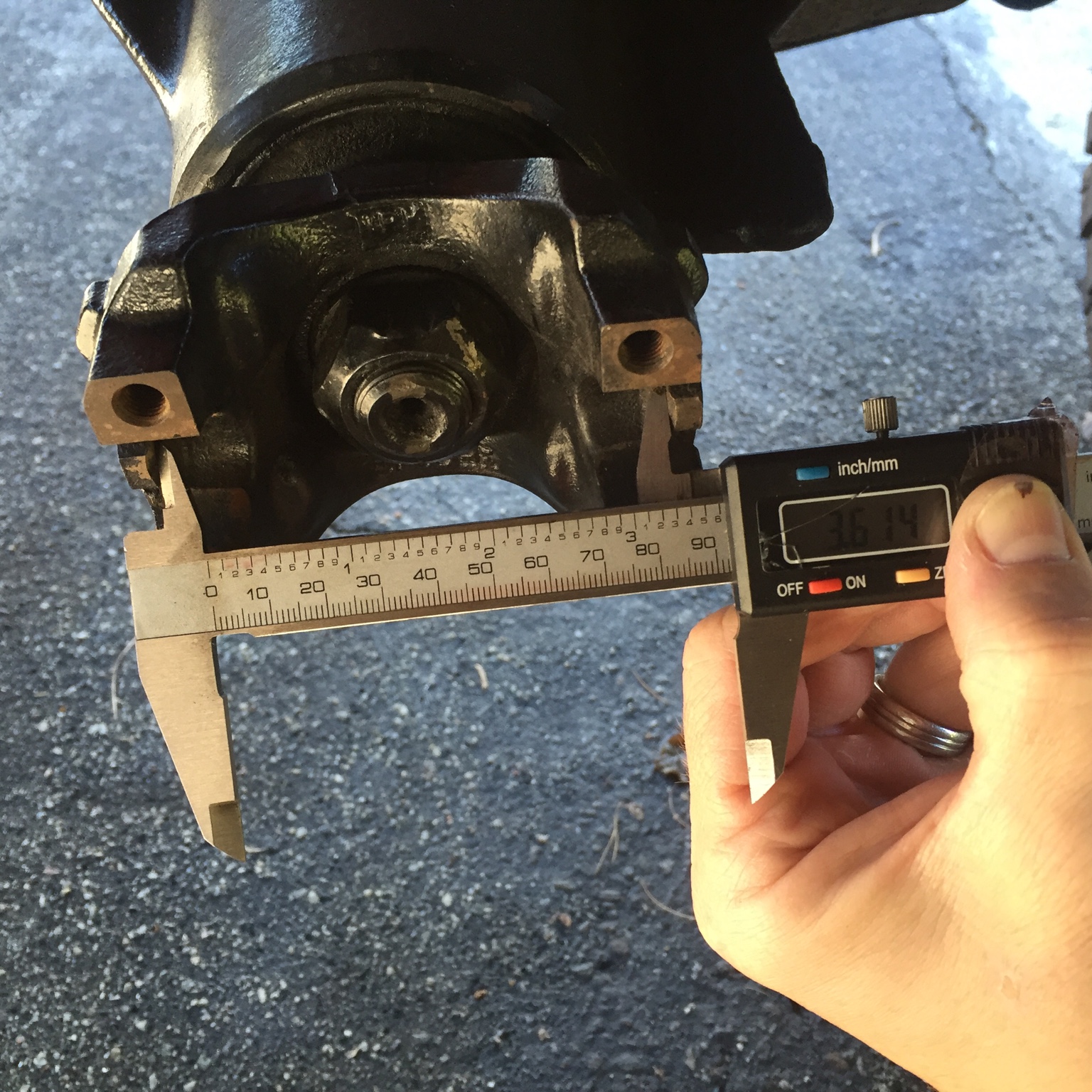

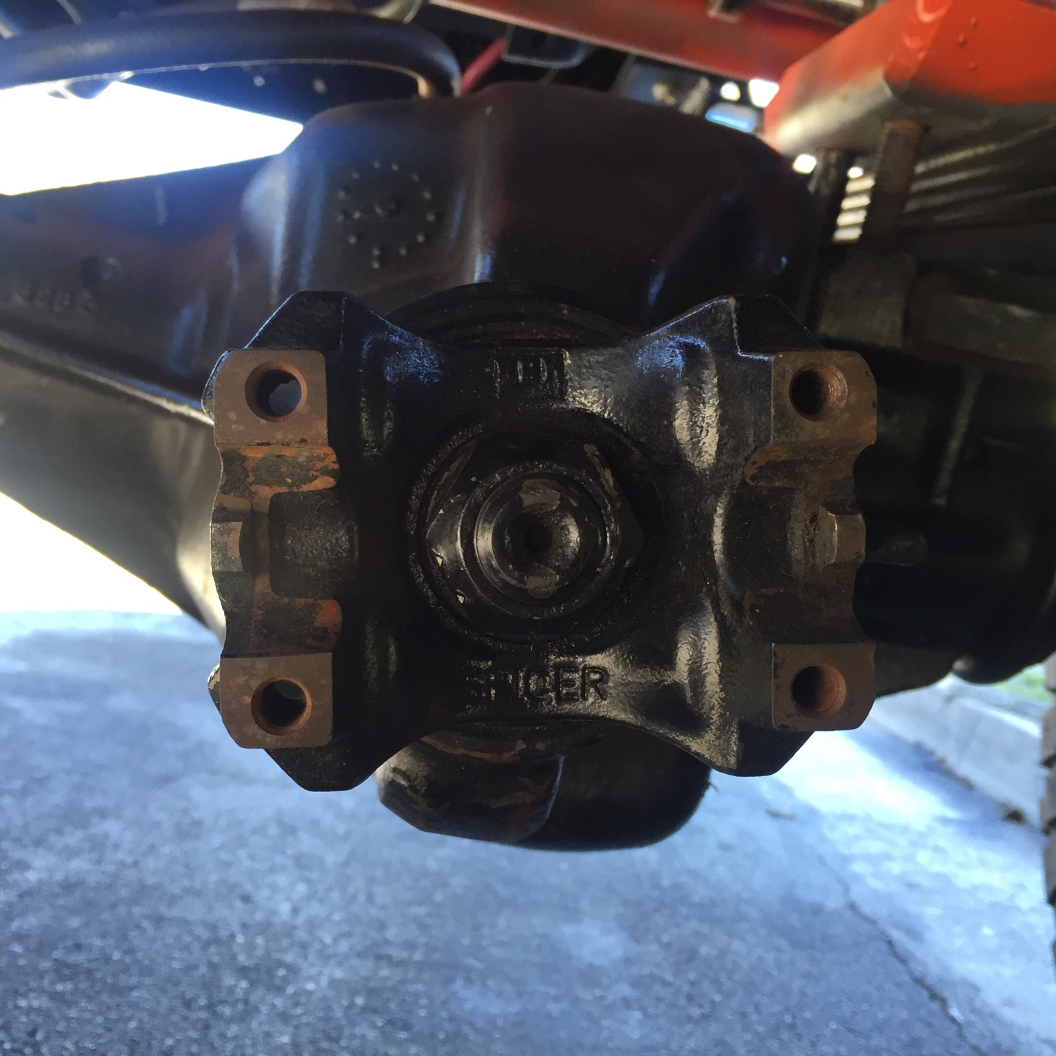

I will go and measure again, but I am almost certain it is 1350. My axles came with the 14bff 4.56 Detroit rear, Dana 60 4.56 trac lock front. I know for fact the rear is 1350 as I ordered a driveshaft for it.
My axles are from CUCV, 1350 rear and 1310 front. But no locker of any kind in front, so maybe that's indicative of something.
you guys are killing me. I had to go dive under my truck to prove to myself I wasn't going crazy.
no, I did not so, that could be the difference. I was under the impression that some came with 1350. Guess I got lucky
