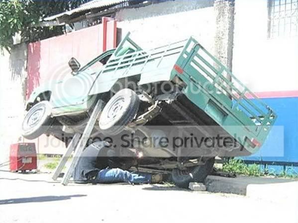

That's crazy. He needs to use the proper procedure, as shown below...
That is a classic - always makes me laugh.
Notice how he carefully chocked the rear tire?
It is perfectly safe. I'm sure that guy has carefully measured the amount of gas in that gas tank he is welding on so that it will explode with just enough force to throw him out from under the truck before the 4"x4"s slip out and fold him in half.
If you look carefully it looks like he has a welding helmet on, and steel toed boots and a good wheel chock. What could go wrong?
Actually if that guy didn't win a posthumous Darwin award for that stunt, I'd like to call him up and get the first six numbers that come into his head so I could go win the lottery.
Maybe Fireplug should try that with the Jeep guy. :D
