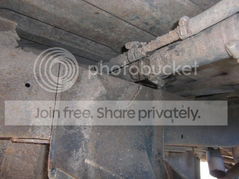

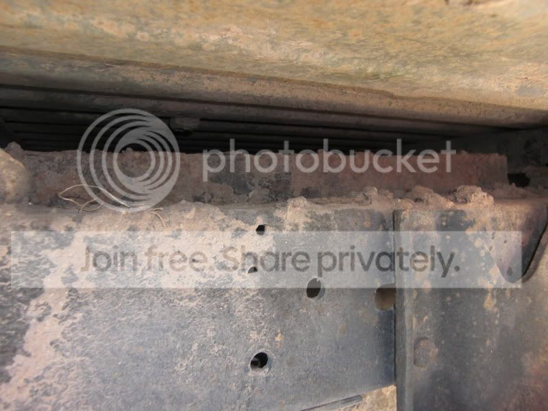

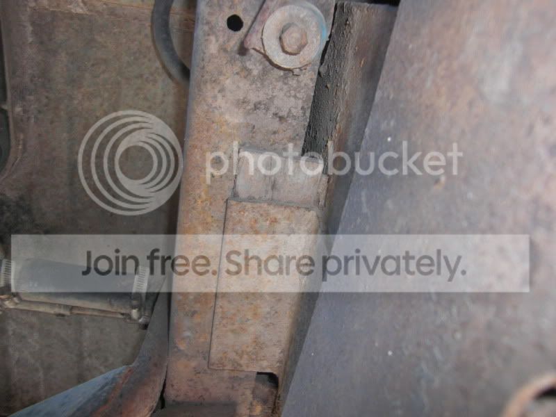

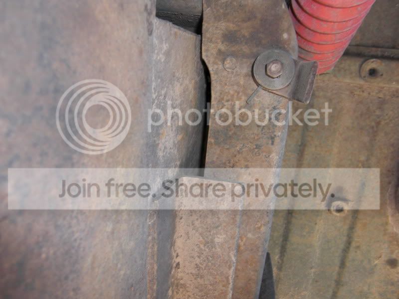

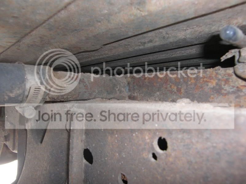

here are some pics.
My thought is that the filler neck sticks out, so the tank is going to have to drop down on the driver side. I dont think it is going to be able to without hitting the framerail and binding, and even if it did i think the filler sticks too far out and will hit the bottom of my tub. Clearances look tight and that neck looks awefully long.
Interesting, doesn't look like a stock tank. They had to get it in there some how, I would try drooping it on an angle it might just clear. It looks like it might hit the tub too though. Maybe cut a few inches off the filler and get a longer rubber tube.

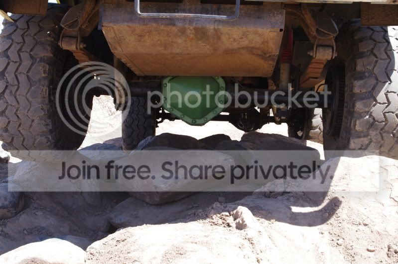

here is a picture from the back. All i can do now since it is dark
I took mine out by myself yesterday without a floor jack or anything...:doah:Ill never do that again. Turns out i had like 10-12 gallons of gas in it, and that made it a real bear. i took the bumper off and after getting the straps undone it just kinda fell out and i took the hoses off.
