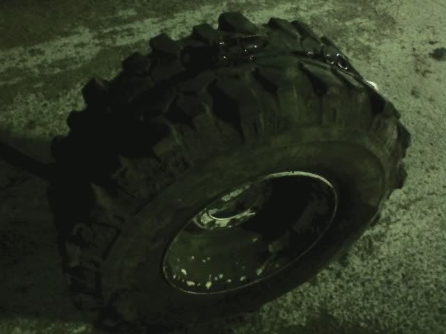

how to re-seat and inflate with WD-40

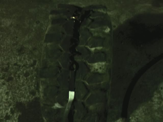

It works. My friends mount big tires like this all the time. The smaller the tire is the harder to do though and you need a pretty beef ratchet strap. Like a 10,000 pounder.
I do it with tiny ratchet straps all the time.
Martin
I have done small trailer tires with a small strap and had no problem. I also mounted my 35"s without any problems.
36x12.50x16.5" 1" ratchet strap from Wal Mart.
Martin
I tried ratchet straps then a 3/4ton comealong on my 44s thank god for ether....
And that is in the shop with a compressor not out on the trail...
kinda a stupid ? i guess but when you say you use ratchet straps... how exactly? just strap them down til the bead meets the edge of your rim and fill?? or..... fill me in here.
Little 73redblaze from prunedale ca asked:
And you asked for it brings you
