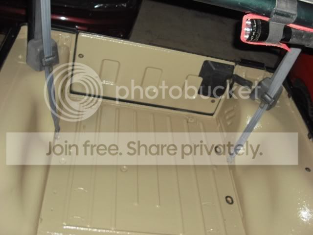

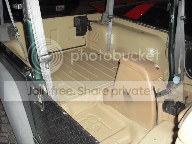

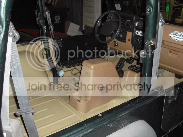

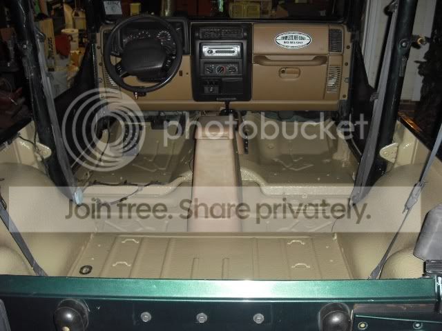

So that's about it! Do all of this and you'll end up with something that looks like this Jeep's coating:
