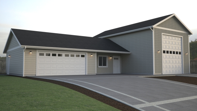

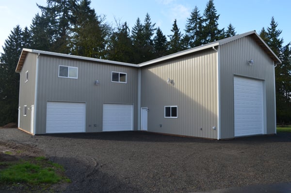

I thought about doing an "awning" off the side. Basically just an open bay for rv parking. Not that i would have an RV but it just seemed like a good idea. I would probably mostly use if for a place to pressure wash stuff. Kinda like the idea here,
images
Or like the building on the right in this pic,
