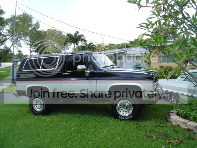

Ok first off i want a stance exactly like this
Guy said 33x12.5 mickeys with no lift on 15x10 rims.
I like how wide they stick out, but is being that wide going to destroy ball joints and such?? I only go up to the dunes twice, maybe even 3 times a summer, and besides that no offroading for it. And idk for some reason other trucks with 33x12.5 tires with 15x10 rims dont seem to stick out like this one, but im not paying an extra 200 per tire to get a 33x13.5 tire.
How back set or what not do these rims appear to be??? I messaged the guy but he didnt say anything back.
When i compare pic of mine with a pic of his to a pic of mine, wheel clearance seems to be the same as mine with 32s. So i think i will do a zero rate lift all aroun to get that extra inch or so and help with turning. Hopefully ill be able to not need new shocks but idk.
But that is the look i want, nice, classy, stock, but a little beefier.

15x10 wont rub unless you had like.. 8 inches of backspacing.
Mine is stock suspension, 3 in. body lift, 35x12.50 on 15x10's with 4.5BS and they have never rubbed unless im turned ALL the way and my tires are tucked.
How much back spacing you think those wheels in that pic have??
I have the factory fender flares/running boards on my burnt burb. So I'm trying to fill that extra space. The wheels sticking out that far wont hurt anything untill you get to about 75% of the wheel/tire sticking past the hub face. Then you get into issues. But its still not gonna kill bearings every year or anything. I'm thinkin if you do the zerorates, 10" wheels and the 4" spacing youll be ok and happy. The one in the pics is slightly missleading due to the angle it was shot. You can make the rear match the front with 1.5" spacers. I'm not possative on if it will rub or not with 10" rims. I'm doing a 2.5" lift to make sure since I have the flares/running boards. But that is the rim/tire size I'm doing I think.

the tires in that original pic that you are referring to aren't sticking out that far! It's the angle like it's been said already.......15x10 with 4" bs is what you want.:waytogo:
Ok lol,will do, then ill just take all my pics from the side lol.
I just wanted to know if sticking them out was death on bearings and ball joints pretty much
