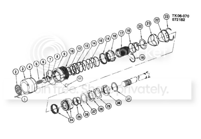

Auto hub diagram

Oh and thanks for the diagram. My hubs are set up exactly like that... so it makes no sence at all to me that they suddenly don't work. Thats why this whole thing is so fustrating.
