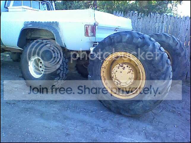

actually the perches are on top and bottom and could just flip em over . . only prob I think i'm gonna have if I do that is the vent tubes on the rears and on the back the break lines would be under the rear and probably get torn off . . . i had heard that on alot of the big rears you could rotate the hogs head 180 degrees and put it back in to flip the drive shaft rotation . . that's why i had pulled it apart but these are unable to be rotated like that . . .

Cool build!
That first picture (the one with 44's on the front) reminds me of a Mad Max vehicle.
Very cool:bow::bow::bow:
oh yeah and i just think this is a cool pic . . i never thought 44's could look so small lol
Pretty cool setup you got there. 15-20 ton axle huh? What size tires are on those?
yeah it's a little ugly right now .. plan on doing the body work and bumpers lately and those are 53's (17.5-25's) on it right now . . suppose to be picking up a set of 67x34-25's when the guy that has em gets back from overseas .
edit oh yeah fogot to add 3rd member is 4.63 and has about a 3.5 or just a hair more at the wheels for a diff reduction of right at 16.7
how much did you pay for the wheels and tires? I work at a tire shop that deals with bigger stuff like that. those tires are expensive even used. we just sold a pair of used 20.5-25's for $550 each, thats the next size up from what you have.

the 17.5's came with the rears. . . . the 67x34's i'm getting for free suppose to still have awsome tread on em
