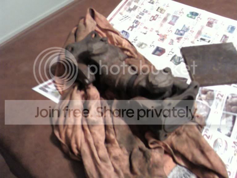

guess the axle and what size theese u-joints are :eek1:
next to a d44 shaft
by itself

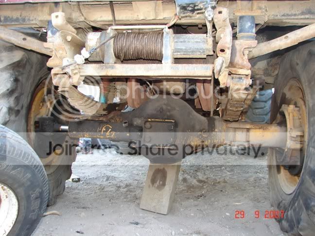

hey that's my truck . .was just coming over here to see what ya'll had to say about it since jay said he was posting it over here lol
steering ain't to bad . .
full hydro

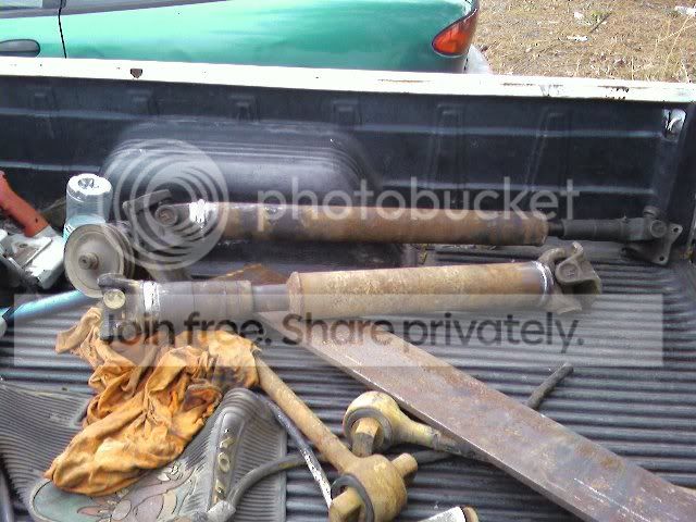

the driveshafts
one is only like 1410 joints the other has a 1480 in one end and think the other end is a 1510 or 1550 didn't measure it so not sure . . . the intermediate shaft i'm running has 1500 u joints with bolt on side plates
oh and by measureing out the axle shaft joint it comes out to a 1710
