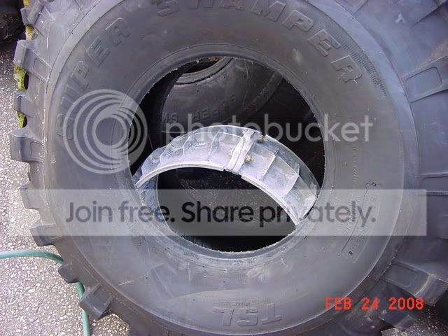

Ok that clears that up. So the outer beadlock ring needs the magnesium piece to bolt into inorder to lock the bead?
The outer ring on an H1 is simply the outer "half" of the rim. The mag runflat or pvc insert goes inside the tire. Once inside the tire, the two pieces of rim are each insert into their perspective side of the tire and bolted together. Once bolted tight the tire beads are pinched between the insert and rim lips.
Take a look at my pics -
The insert is not actually bolted to either the inner or outer shell, so nothing to line up.
