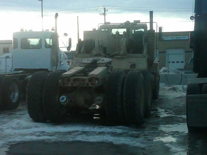

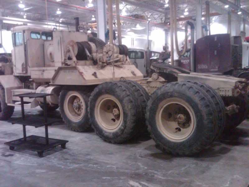

Soooo what your saying is, then the dual 45,000lb bradens on this old warpig could potentially pull the world over. :thumb:
They might not turn it over, but they would give it a hell of a yank.
