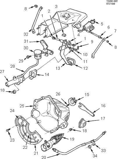

What attaches to the round shoulder that the clip is running through? If I read this correctly there is no big spring for pedal return because line pressure returns the pedal.
Yeah, I noticed that too when I did my hydro conversation, where it wouldn’t fully return until it was filled with fluid and bleed. Don’t sweat it, hook it up and enjoy a nice smooth easy clutch to press.
Here is a cool picture of the ’85-’87 (’91 R/V) hydro system. Too neat not to share.
