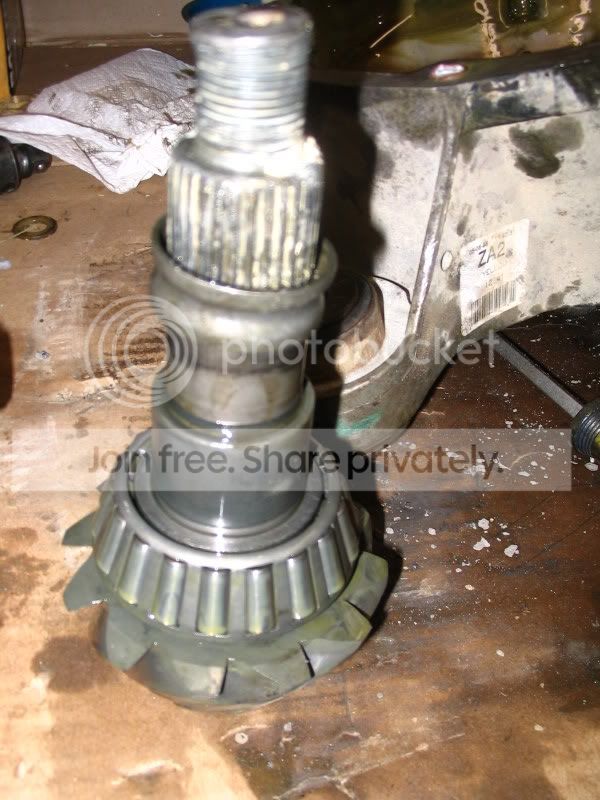

Ok... this is starting to piss me off. :angry1:
I went to Harbor Freight and grabbed a cheap set of three 2-jaw pullers. I used the large one, and got the pinion yoke off with EASE.
Thanks for that suggestion...
So, I go to knock the pinion itself out. NO GO. WTF. I gave it Hell, I really did. I beat the ever-lovin' shiit out of it with the hammer, but it's not budging. I really don't want to f-up the gears since I plan to reuse them.
But this is insane...please advise me :(
brass punch. a.k.a brass tube or anything. it will break before the pinion will. snapon is like 60.00 and harbor is like 10.00 but you can go to a metal place a get a scrap piece for cheap.
