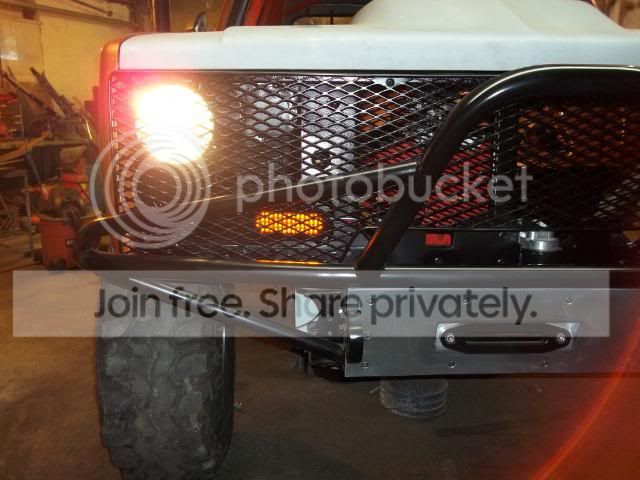

second gen squares, converted to round.... :D
that's sexy!! I like what you did with the grill, and the stinger bumper.. your truck is an icon!! I dunno how many times ive flipped through your build thread. just to spark an idea
thanks, my idea's are everyone's... feel free to pilfer anything that suits you.. :haha:

round headlights rule.... :D
