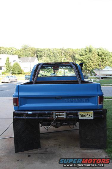

oh less than $50 with the hardner.. now I may paint it again.. i did the spray cans (they sell same color) last on the inner door and fenders and that messed me up as it is a slight different color since it doesnt have the hardener...
I sanded the surface rust and primered truck again...
From
during
to
big ass flaps - reinstalled
Looks great from here!....just dont say "FORD BLUE" too loud near it when someone asks what color you used..it might seek revenge!..
