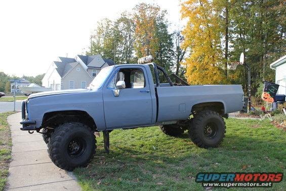

in 1992 i painted my truck with 20 cans of flat black... after a bit of oxidation the paint would smear off onto your hand or whatever.. it was a pain in the a$$..
this round I just wanted to stop the surface rust and get a blue truck..
tractor supply store..
sacrilege i know....
Ford Blue on a Chevy... :haha:
but whata ya think?
oh less than $50 with the hardner.. now I may paint it again.. i did the spray cans (they sell same color) last on the inner door and fenders and that messed me up as it is a slight different color since it doesnt have the hardener...
I sanded the surface rust and primered truck again...

Crappy pic here I know. I used Rusto spraybombs for the first 2 coats. Went with the cheaper option and Herculined the lower body. That was 3 years ago during the winter under a halfazz tarp tent with a K1 torpedo heater. Then foam rolled straight Rusto from the can during warmer weather. Never hit it with sandpaper afterwards. I got the idea to do a fade from white thru gray to a better trimmed black AND from glossy to textured Herc. After alot of reading I found Herculiner and marine deck gloss have the same base. I may just lose the fade idea but the white is going to be redone with the deck paint and I'm definitely getting rid of the cartoonish overdone wheel well effect:doah:And yeah I have NO 4wd and I let a homeowner talk me into trying to climb his mountain driveway with a glaze on it :angry1:
but whata ya think?

That looks pretty good...if my comes out that good I'd be happy. :waytogo:
love the snorkel too!
