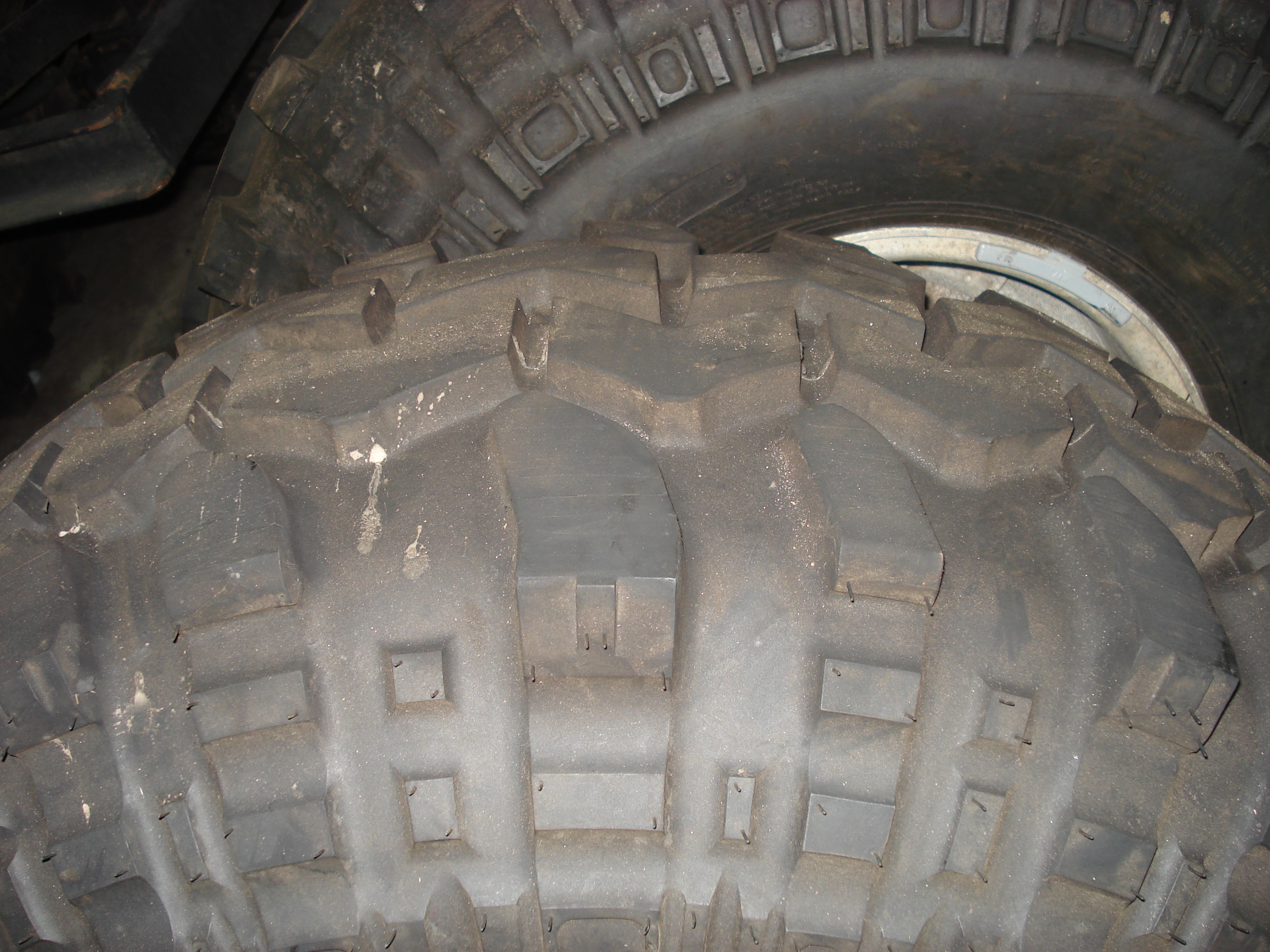

If all goes well, i'll be picking up a set of 38.5x14.50r15 TSL/SX's mounted on 15x12 Centerline wheels for $800. Not sure about the offset yet, but he thinks they are at 4".
These are the tires in question and a bad pic with the rims.

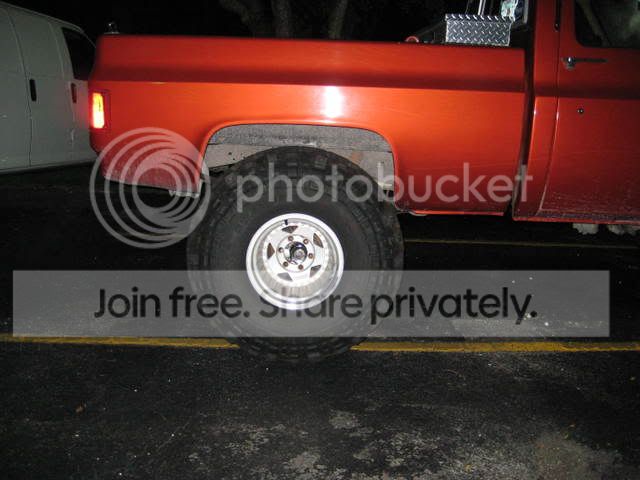

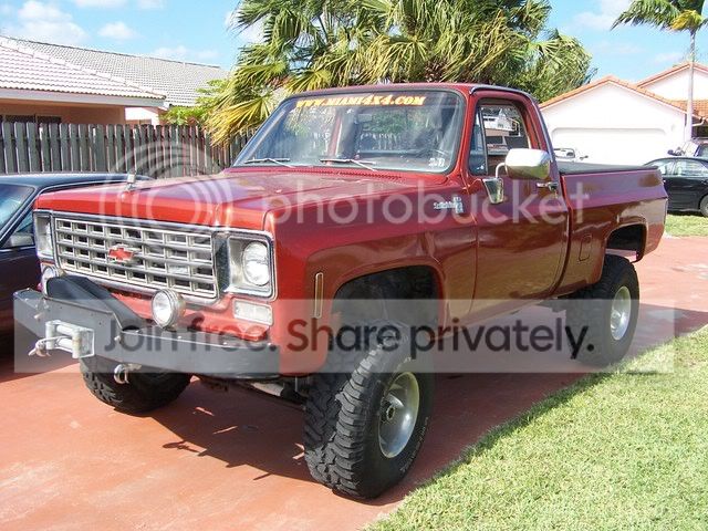

Now my K10 has what i think is a 4 inch lift (springs & blocks) with clean fenders and no body lift. It also has the ORD crossover steering on the D44. (before you say it, i have a light foot, an OX locker and cromoly axles + it's a mud truck cuz that's all we've got)
This is how the truck sits with 35x12.50r15's and 3.75 back spacing right now.

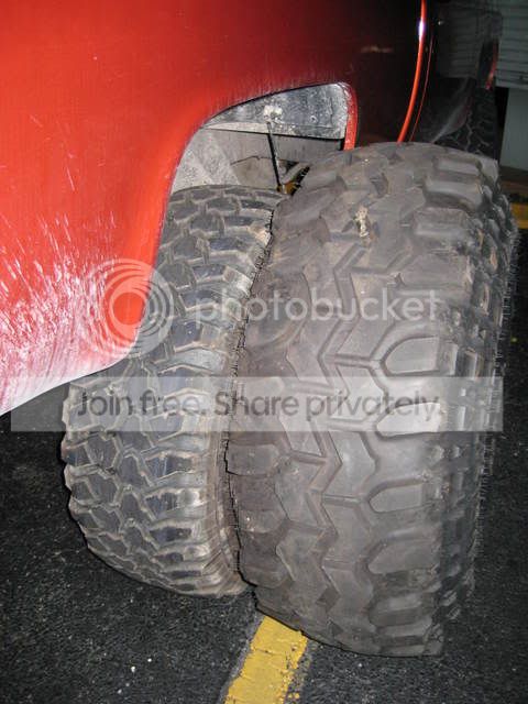

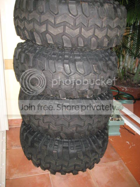

Well, i just got back from buying the tires and rims. These tires have like 95% tread left on them. I don't think they've ever been offroad. I'll install them on Friday. Then i should have a better idea of what to do.
