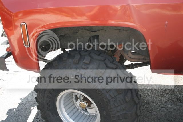

well, i finaly got around to mounting the 38.5's to get a better idea of where i stand. I can barely get out of my driveway without rubbing fenders. The new 6 inch springs should solve that problem at least on the road.

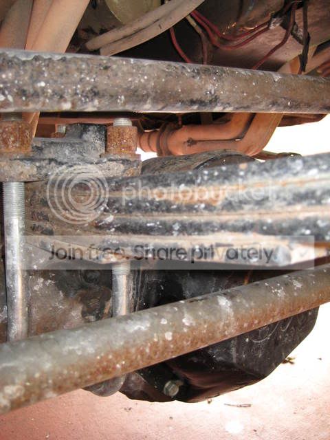

If i go with the spacer (to save money) would i still have a problem with spring/tie-rod contact?

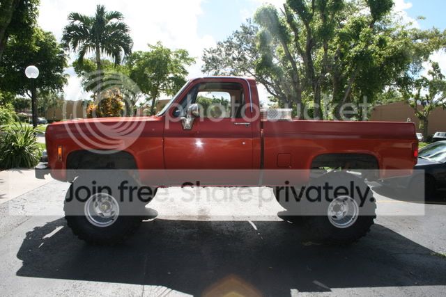

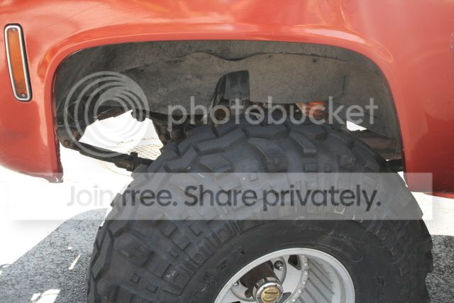

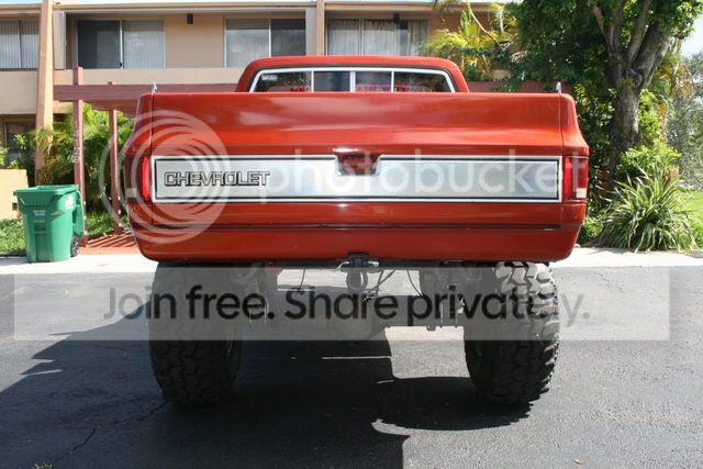

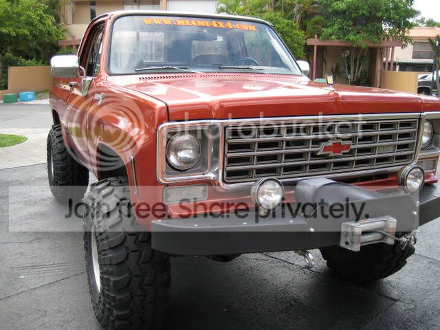

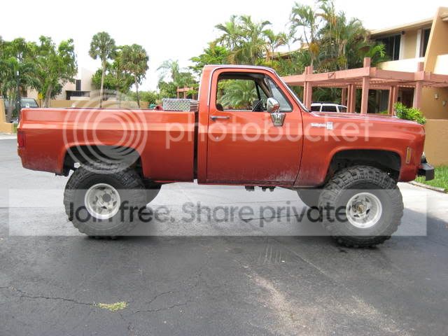

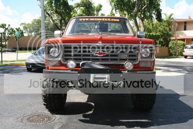

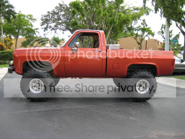

Here are pics with the lift installed and no extra weight in the bed. I'll be ordering a set of zero rates for the front to lift it one inch and move the axle foward 1-1.5 inches. I'll also be trimming the front lip on the front fenders. That should solve all of the rubbing issues when it's done. If i need an extra inch, then i'll throw on a cmall body lift.
That's a nice looking truck.:thumb: But 1/2 ton axles with 38.5s is kinda pushing your luck isn't it?
Also, it does look to me like you're going to have really tight clearance to the tie rod once the zero-rate is in.

I will simply say that it's no d*mn fun at all to get it back to the road after the semifloater breaks an axle.:rolleyes: Recently had to do that around here, and he was running 37's. Good luck!:D
Damn I love that stance! That extra inch up front and some trimming would be great. :)

i just love putting thoose pics up showing that you can wheel on half tons,they wont break as soon as you get on a trail like some people seem to think around here...
I think the 1/2 tons will be fine. We have guys around here running 40's all day with 1/2 tons It's all in the way you drive. With a light foot and realistic expectations, 1/2 tons should last. These axles should also have upgrades inners, but i haven't verified that yet. I figure that it won't make a difference. If they break, then i know at that point. Plus with the OX in the front, i can run open until needed. Also, all we've got here is mud, so the worst thing for us is hitting a burried root or rock at high speed.
