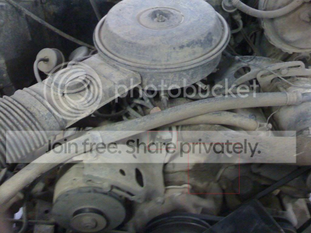

I dont have a camera with me at the moment. But its been over 12 hours and nothing is leaking anymore.. there is just about 4 drops underneath. As soon as I can get a camera I'll post some pics..
Found my cell phone cord for the computer

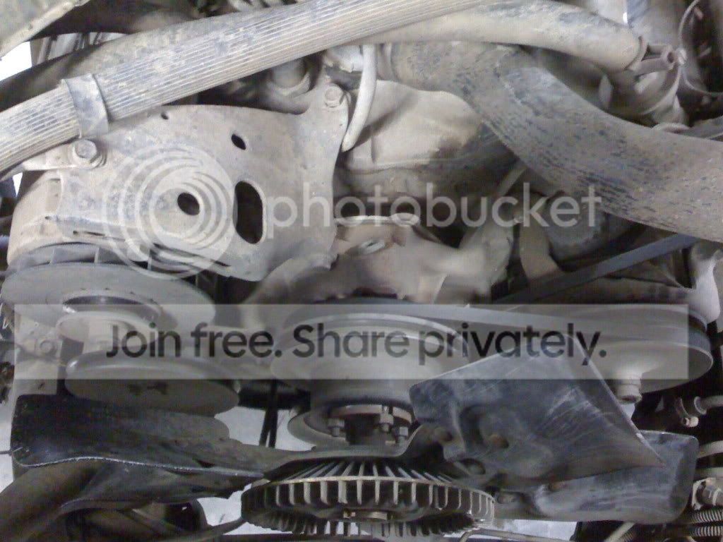

Thats where the belts missing

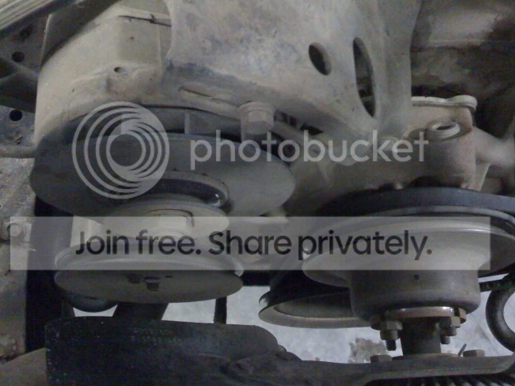

and this is the only leaking looking spots I can find
Both look to be like antifreeze leaks :doah:
I don't see why it'd get hot with the other belt driving the waterpump though. :dunno:
I say buy a new belt and start her up. No leaks = no problems. :D
It was moaning because that belt isn't enough to move the water pump and the steeing pump so it was slipping under pressure, I'd say you got off easy, just replace both belts because you overworked this one too, and check your fluids and hopefully you are ok with only maybe having to replace the battery down the road if you killed it bad..
Wow that is a filthy engine compartment. How can you tell anything looking in there?
