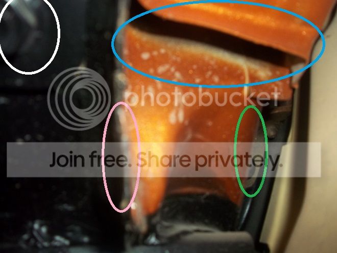

Thanks for the pics, but it still doesnt show where the water comes out at. lol Anyone do close up?
here's the best I coud do in a hurry.. fenders are on all my rigs.. I snapped this off the k5, couldn't find anything in my whole photobucket that showed the area...
blue is the hole.... green is the lower door hinge bolt into the door... ignore anything down low as I have intergrated sliders...
pink is the vertical pinch weld.. ignore white, that's the bolt for my cage flange...
