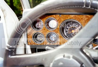

Yes, I know the topic was a diesel tach......just wanted to add to the "tach" part and the location. And this was also a 2010 thread.
Oh I know, I put a tach on my Van in the same location, where there is a blank circle.:thumb:
So Jeff your tach is on a diesel? Thanks for posting up how you mounted it. It fits well in your dash. Unfortunately my truck already has all four of those holes filled with other instrumentation. I am considering locating it above the heater controls in the useless square box area.
I realize it is a 2010 thread, but I know the guys who started it are avid members and would be able to respond constructively.
Thanks Iceman, I'm going to order that up and give it a go.
No, mine is on a gas engine. I've done this install 3 or 4 times now in the same location and it's worked out pretty good. I have no idea about diesels or where you even hook up the tach lead but according to summit, they do make "diesel specific" tachs that are the same size as my gasser.
http://www.summitracing.com/parts/ATM-2888
I had the tach in there from many years ago and then I just recently swapped over from cable speedo to electronic speedo. And that required a whole new cluster. After driving around for about 3 weeks with no tach, it drove me nuts so "a hacking away" I went. The backside of the cluster is gone with a large hole in the back but it sits flush against the gauge bezel so it looks "close to factory".
