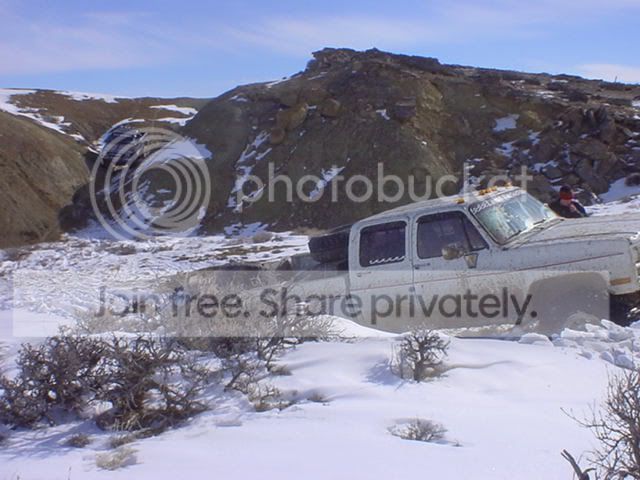

don't worry, been there done that. My box ripped off and spun around and took out the radiator and all. the front of my frame drooped down. Spend 8 hours getting it straghtened and aligned back to normal then welding, grinding then weld on brace AND bolt on brace. Never a prob since.

I will if you promise to pay up after you get your truck welded back together.... :D
At least your frame isn't kinked, just drop the steering box and come-a-long the frame back together. I would grind a V in the crack valley then weld up. Grind the weld smooth then put an ORD weld on brace on. Also install the bolt on brace too. Well worth it for both, especially after the damage

:rolleyes: lol.. i will. like i said before money is real tight. im just trying to not make any enemies before i can pay.. thankyou for posting the pic...gosh gimme a break im a just a kid tryna get his truck going again! lol..:crazy:
wow.. thats a messed up frame you had there! that must have been hard to fix :bow: ... on the plus side of this whole thing.. maybe my steering will finally be tight:doah:i think this could have had something to do with it :thinking:..:haha:hahah

hence the managery of chains and come a longs in that first pic to steer it down. No coolant and barely running because low on fuel
