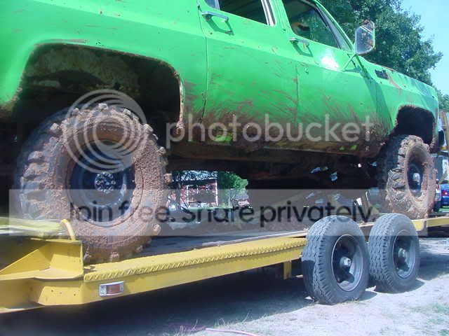

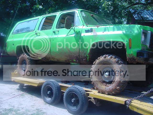

You know how this forum works - it seems like no two people can agree on the same thing, ever. But, several people have expessed concern of the loading method of this 'burb. There must be something to it.
I haven't stirred up a pot for a long time so, if you look at the angle of the bed and the angle of the trailer they do make a v. A very obtuse angle to be sure but an angle all the same.
when I see this I cant help but think of a boat sided burb... nothing major..just up to the lower hinge..

PLEASE tell me you don't plan on towing with the burb on backwards. That is a BIG NO NO.
Listen to this guy. I used to trailer a bobcat with an 06 F-150 (company truck). If the tongue weight wasn't perfect, I was either dragging the hitch or swaying like crazy. One afternoon on the way back to the shop, the Bobcat was about 4 inches too far back on the trailer, and I started getting some baaaad sway, to the point where I couldn't get it back under control. I've always heard that the best way to get rid of sway is to throttle out of it (that **** doesn't work, don't try it). So here I am in an underpowered truck towing an overweight trailer that's swaying from one lane into the other with my foot buried in the throttle, and I realize the truck in the other lane coming at me is my mom's. She had to run off the road to avoid getting hit. I finally got it under control thanks to the trailer brakes, but I had to do 35mph the whole way back to the shop.
My point? Four inches made the difference between me towing the load safely and me nearly killing my mom.
just to let you guys know I met up with james last night and he had his burb loaded far enough back to get plenty of tongue weight. I think his particular setup pulled fine.

The burb won't fit foward on the trailer. Its very open roads, no interstate. I take it slow and carefully. In the future, I think I'm just going to save up alot of fuel, and try to drive my burb 70 miles down there..

Couple things, one look at that burb on the trailer, you can tell its heavy on the front of the trailer, and it looks it wouldn't fit backwards with those ramps. And burbs seem to be very heavy in the back to me.
I've towed with my 77 on Mountainexplorers trailer backwards with his 81 crew. I really didn't have a choice, my ragjoint was broken and my truck was pulled into my shop, so I had to back it out onto the trailer. I never had any problem, and his crewcab I think was heavier than my K20 and his trailer combined.
Also anyone who has had there trailer sway on them at how fast? I would never do 70mph while pulling fullsize truck on a trailer. My opinion better slow and safe than sorry.
And to the original thread, that burb looks kickass lifted and painted like that, I love it.

ok guys, I now own the trailer. Simply because of this thread I decided to try to load my burb up fowards, and believe it or not, it DOES fit perfectly fowards. Towed it down to elko again last night, but it fishtailed violently loaded fowards. So bad that I almost stopped and unloaded it and swaped it around, I probably should have, but I just rode down there slowly. Needless to say I towed with it backwards on the way back home. So appearantly with my weight distribution and this particular trailer, towing fowards is a big no no. :eek1:
