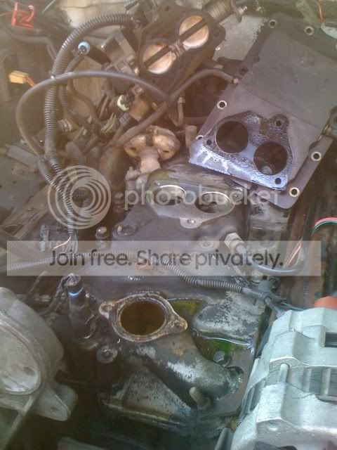

It has taking me since 7am to do the simple little job of replacing a thermostat, I am certianly no mechanic, but it shouldnt take 5 hours to do :haha:
Enter the Supercharger. I had to Uninstall the whole SC to get to the t-stat. I am pretty much over the "cool" factor of having it. I rarely ever push the truck to get any boost anyhow. SO, for simplicity sake, im looking to just uninstall it completely and go back stock and sell the thing. If I ever had to replace the dizzy, egr, wires, or anything else back or under there it would be such a total pain in the arse, especially if I was on the road.

all the carnage for a T-stat swap. ( old one was stuck open )

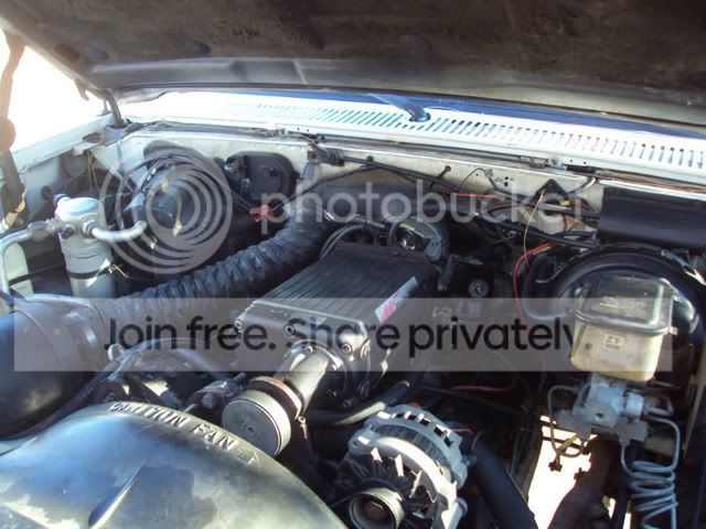

Before:
Now:
